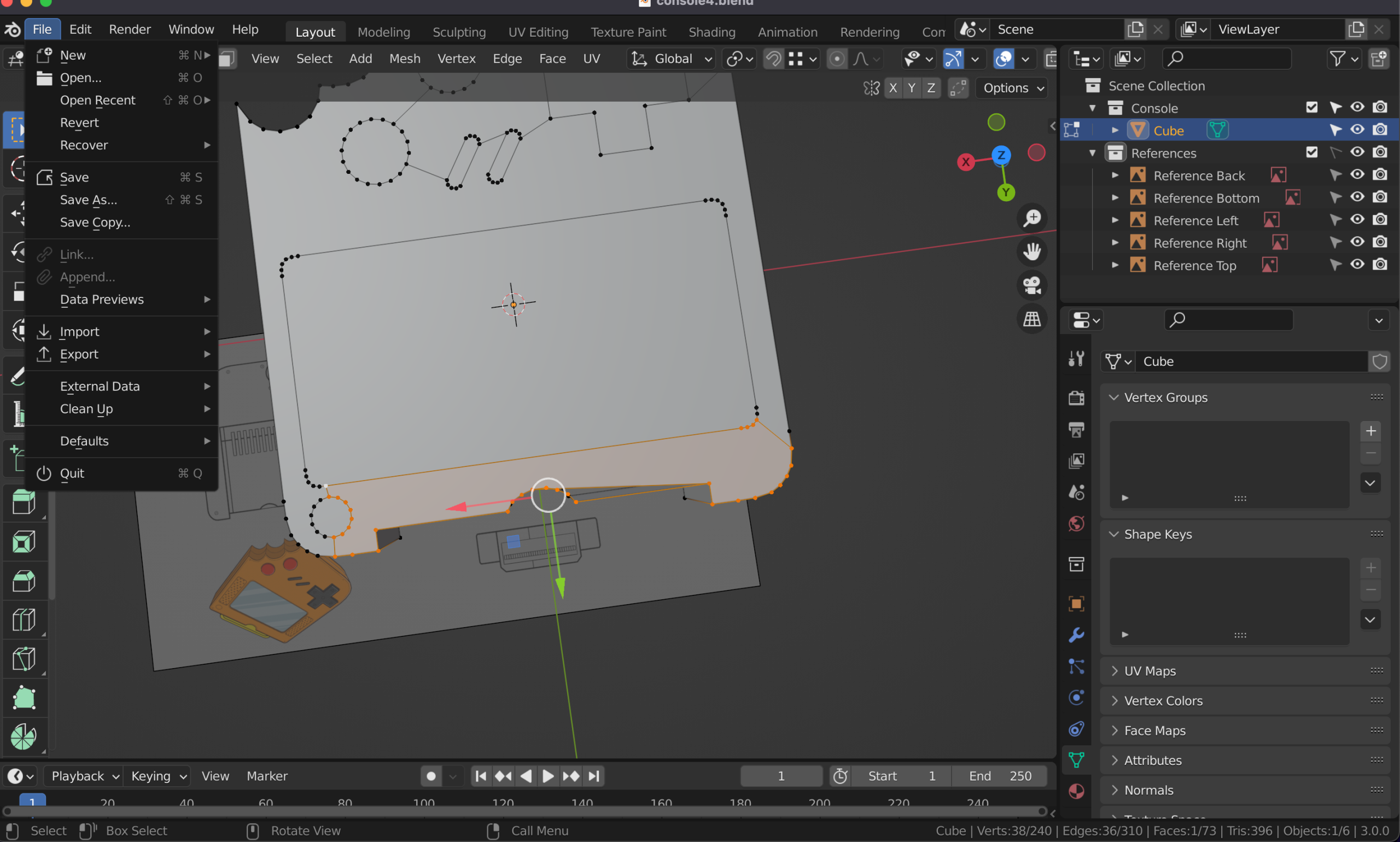

      I am once again having problems in this section. I cannot seem to get some of my vertex connected with the F shortcut (new edge/face from vertex). Everything seems alright from top and bottom but I don’t know what’s going on. I have even deleted and redid the entire console but I am just getting stuck at this part.
       I am using a Mac laptop and I am wondering if it is the settings that is causing this or something else that I am overlooking.
      Would really appreciate if someone could help me out 🙏🏽

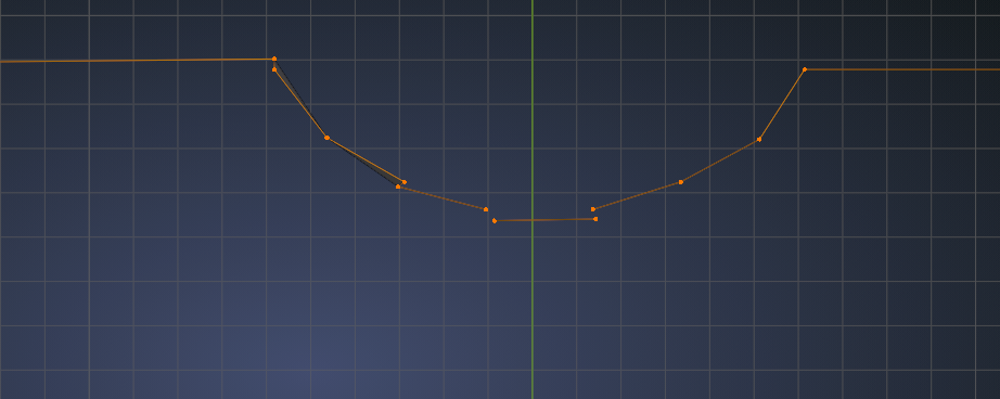

                Hi, you have a few, so-called double Vertices, like you can see here (I pulled them apart, just so that you can see it better):
                Solution: First Select that misbehaving Face (easiest in Face Select Mode) and Delete it.
                Then select All with A and then M > Merge by Distance.
                Now you can Fiil with F.
