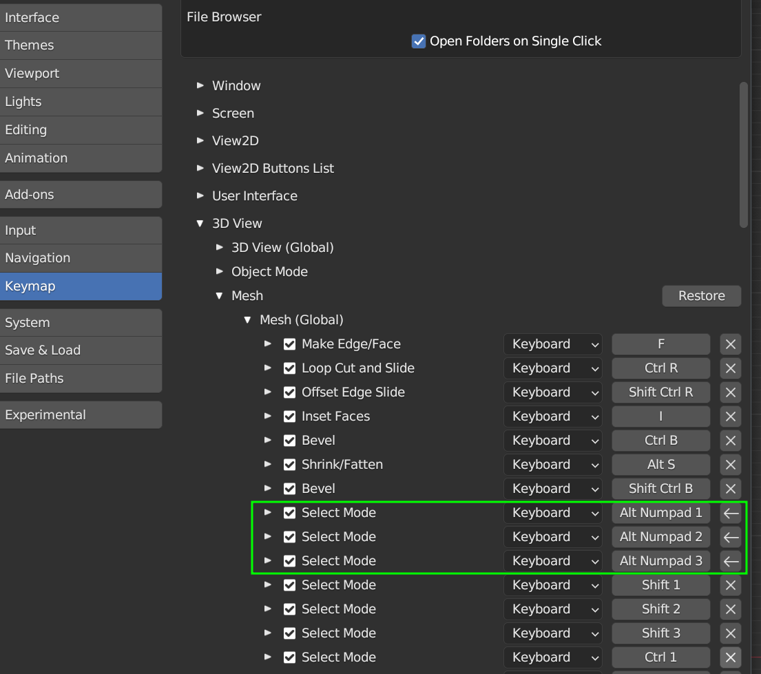

      Is there an alternative for those who don’t have numpad? I’m using the emulation numpad from the settings but when I press numbers 1 to 3 they change the point of view instead of navigating the editable parts of the mesh

        You can change some Shortcuts in your Preferences; for instance:
        Or remove the View Shortcuts from 3D View (Global) and use the Tilde Key for that, or…
        There is a Restore Button if you have changed Shortcuts, so you can always get back.
        #81270
          The more handy option is to use the Tilde key, I’d stick to that.
