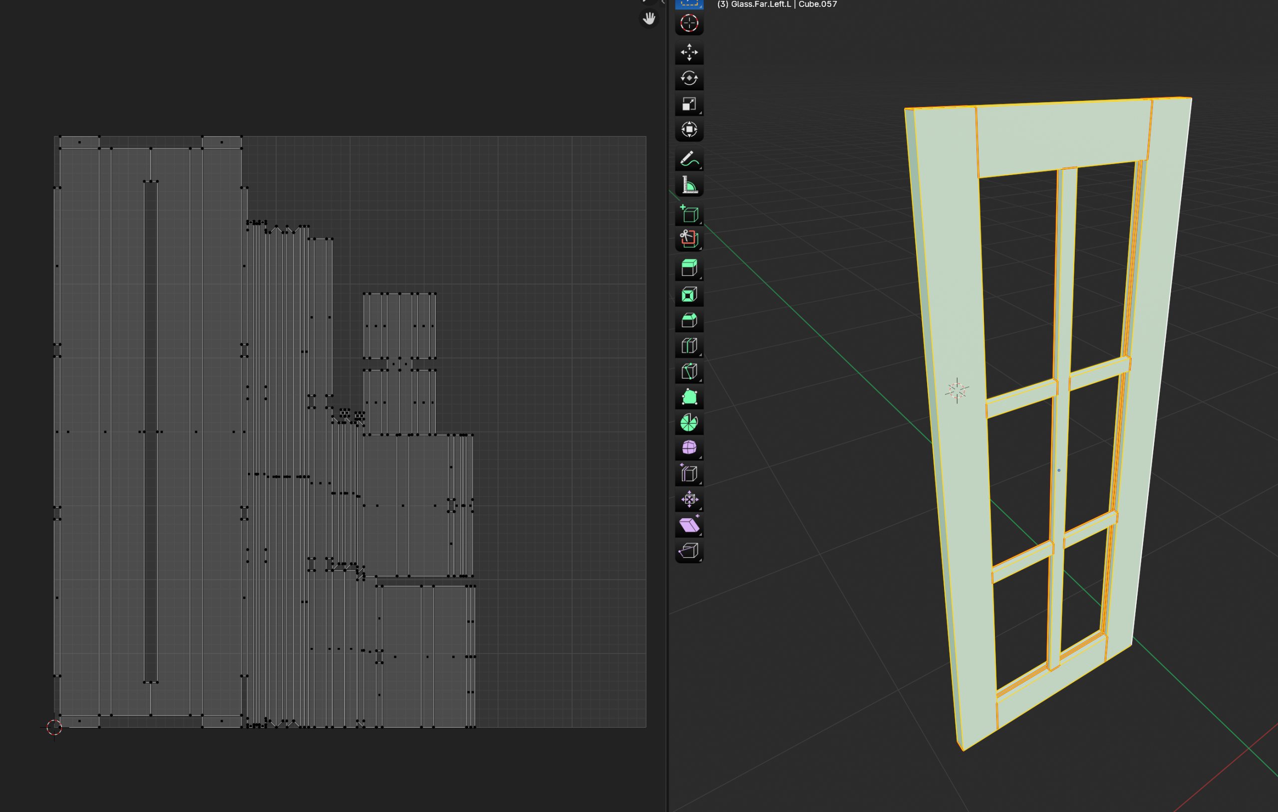

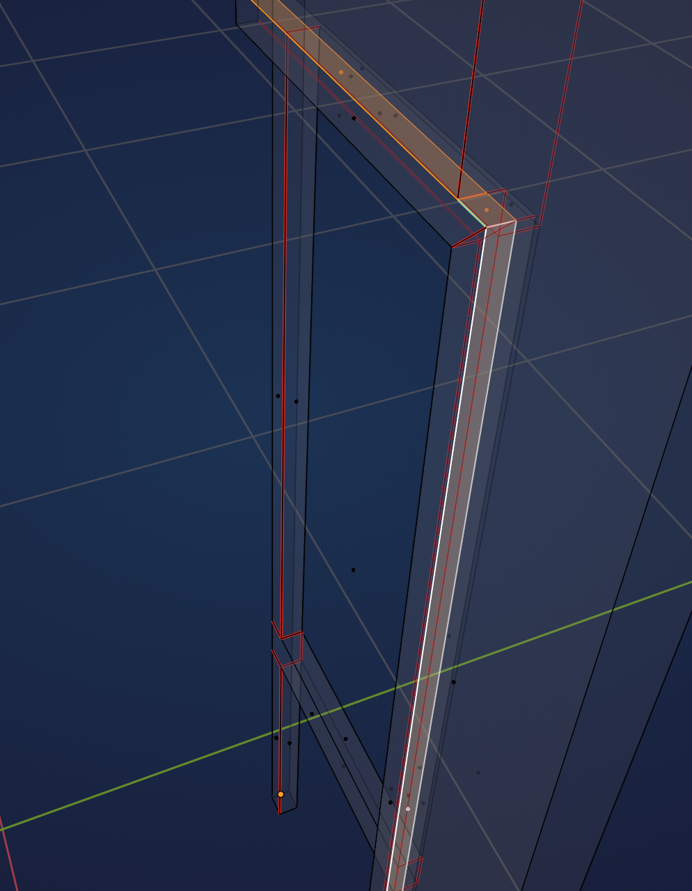

      Oh dear, I cannot figure this out…here is a screenshot and the file, if you have time [no rush, obvs]…
      https://drive.google.com/file/d/148CGWbEUvqQ_aDljyfkTrZX6flt-qseJ/view?usp=sharing
      https://drive.google.com/file/d/1kSJLpXL24RN4scgP7_JUw0VGLEct9c5k/view?usp=sharing
      I have tried a few different corner configurations for where the trim fits into the corner of the door, in order to make the grain align as it would in real life. All my maps come out crooked, even on that quarter of the door. When I apply the mirror and map the whole door, it’s even worse.

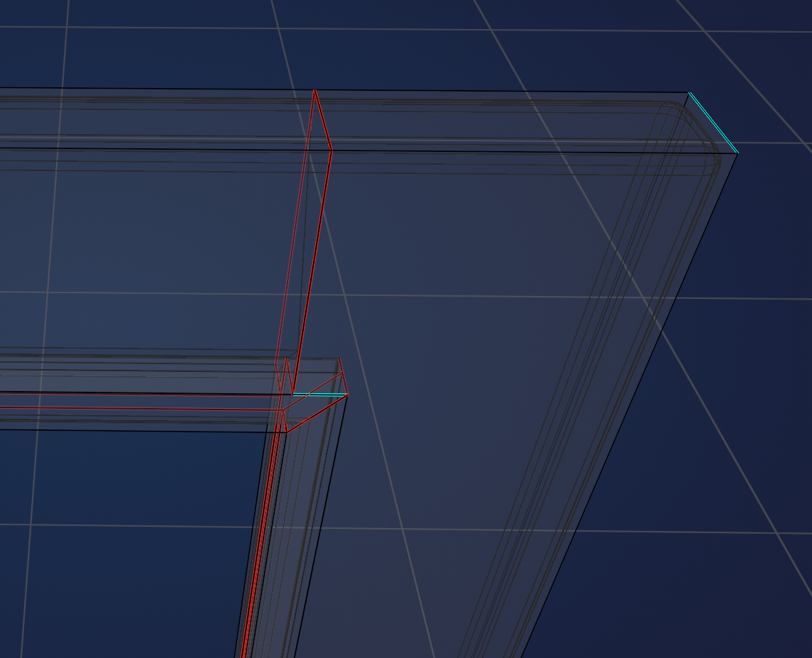

      I’ve spent the past hour going over it in x-ray mode, and I cannot find what’s causing the weird UV angles. My lines seem to be straight, and I removed all the .1 corner bevel weights for clarity. Am I using sharp & seam marking the right way?

        I’d recommend to use Wireframe Mode, instead of X-Ray (but that might just be my personal preference), disable Bevel and Mirror Modifier display in Edit Mode.
        There are some inner Faces that probably shouldn’t be there:
        I am also not sure if Edges should be Marked Sharp (it’s been a while since I’ve seen these Lessons, so maybe there is a reason to use Sharp Edges):

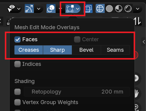

            – Under the mesh edit overlays you can turn off certain things like the bevel weights or seams, depending on what you want to trouble shoot. Here I’d turn off everything but seams to just see those.

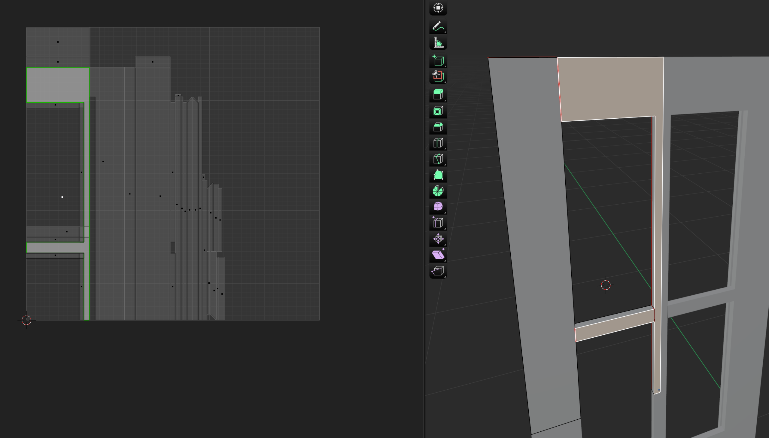

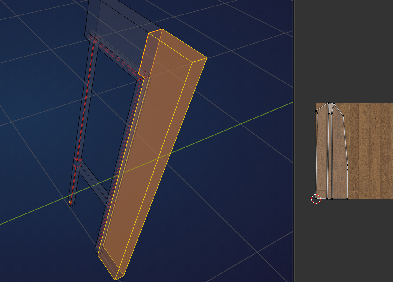

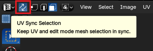

            – In the UV editor you can turn on the sync selection to find the faces that give you the most trouble:
             Just make sure to turn that off again, when you’re done!

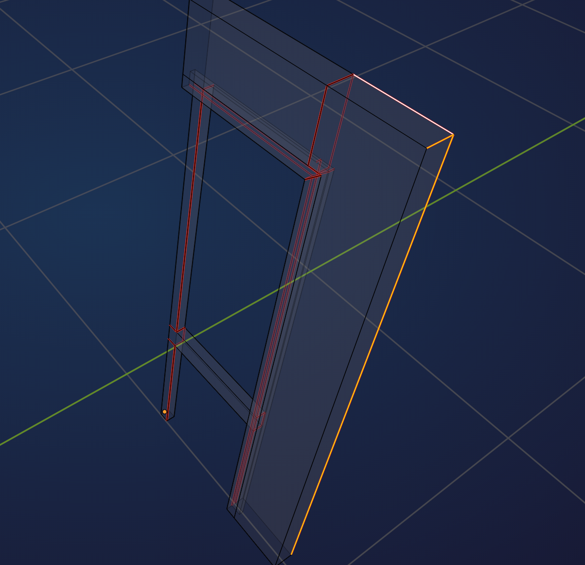

            As Martin pointed out, you have some edges marked sharp, which shouldn’t be. Maybe they’re remnants from your previous trouble shooting? Anyway I would select them all and right click -> clear sharp

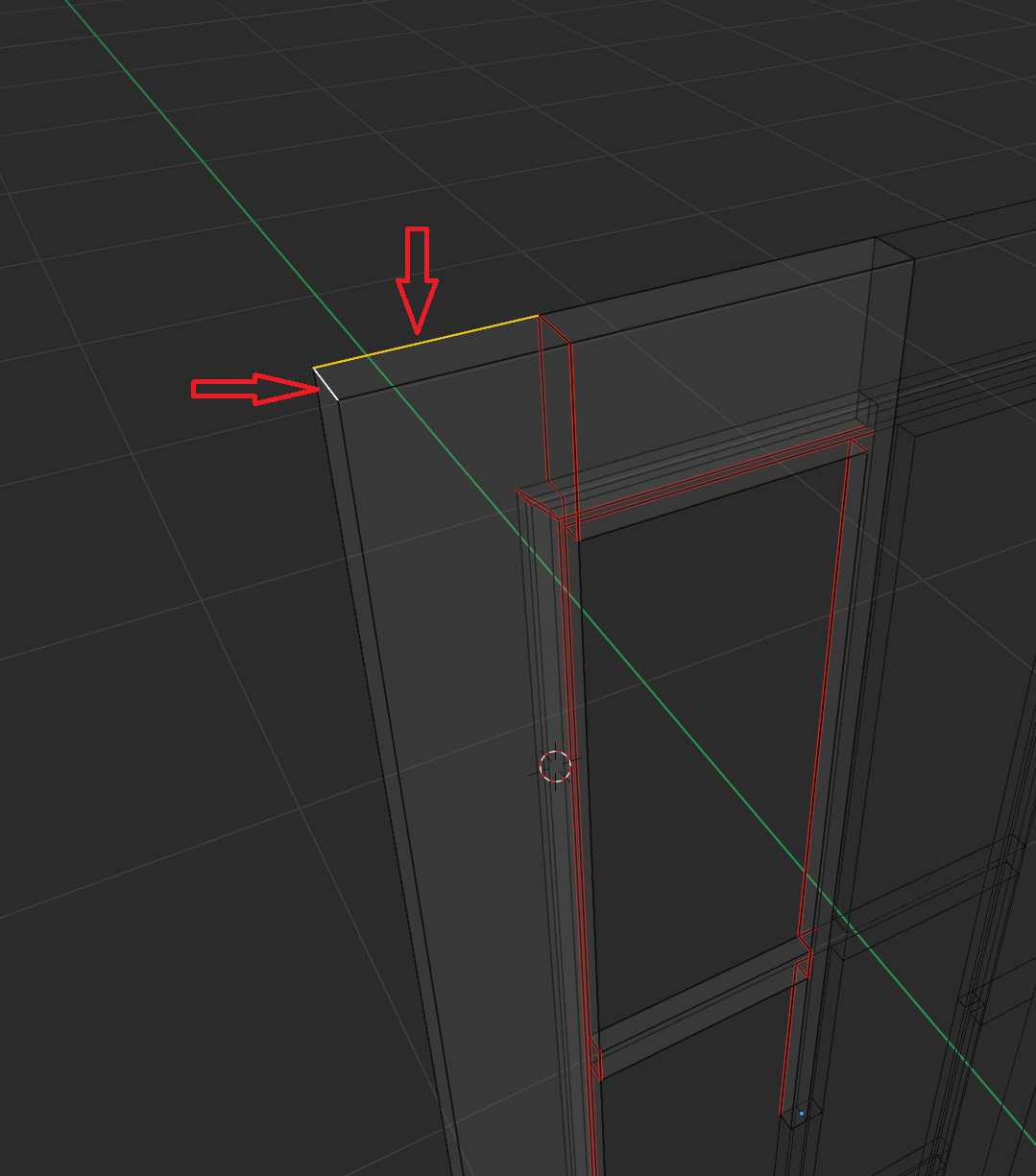

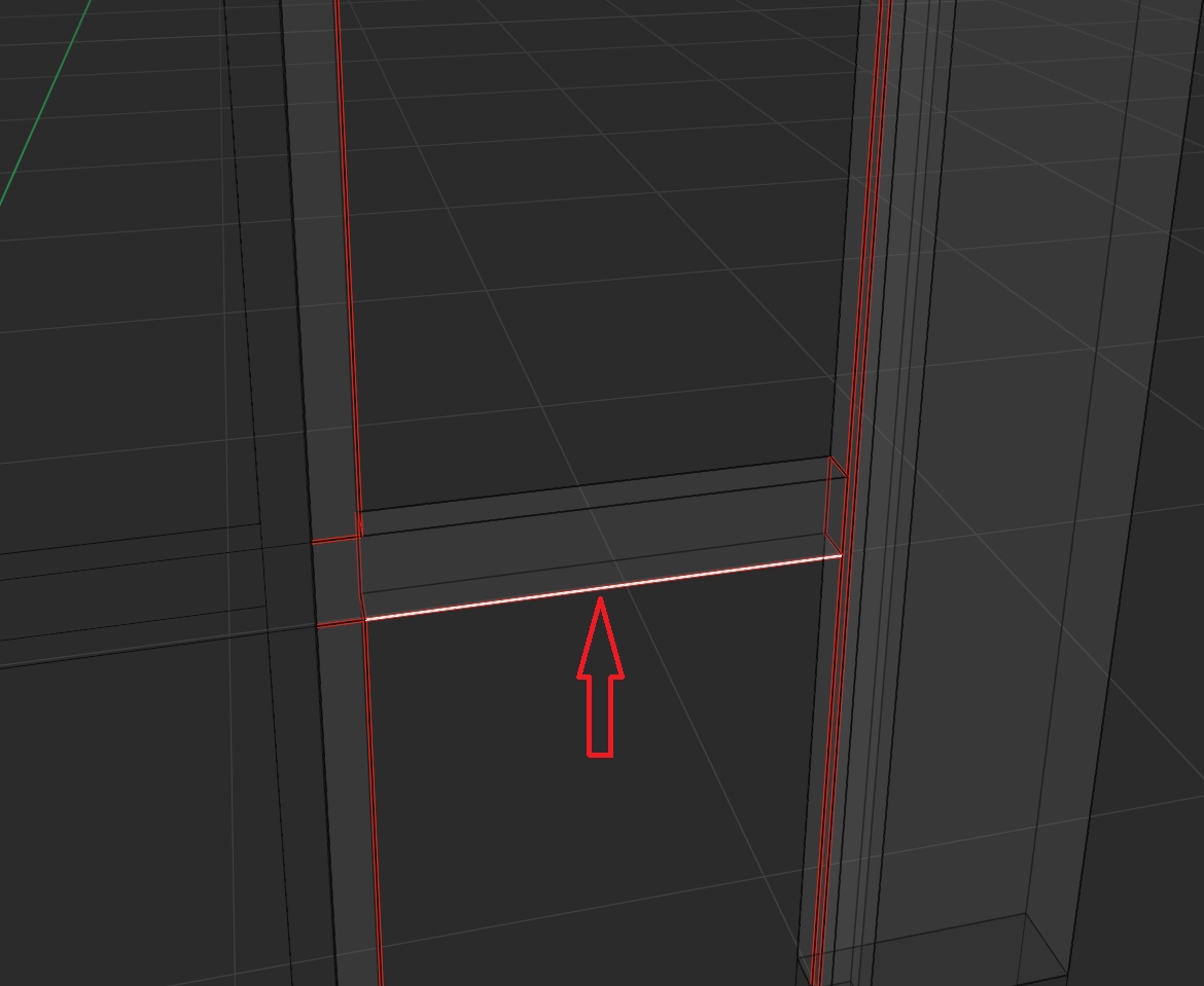

            Next, viewed from the front, the stile will not unwrap properly, as Martin said. I suggest selecting two edges on top and marking them as seam.

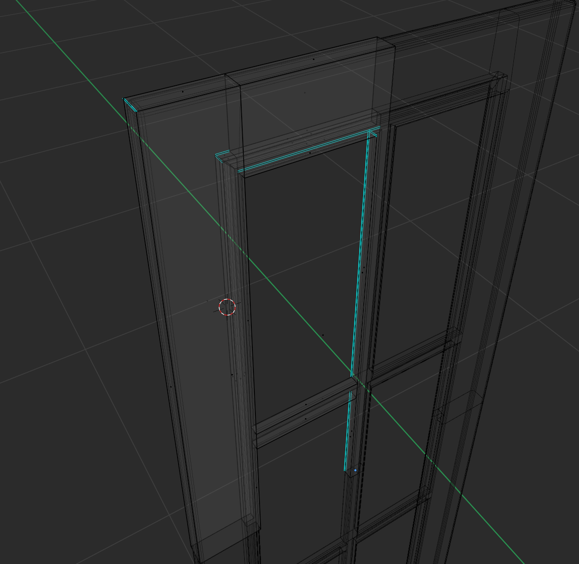

            Your horizontal muntin needs an additional seam too, here seen from the back:

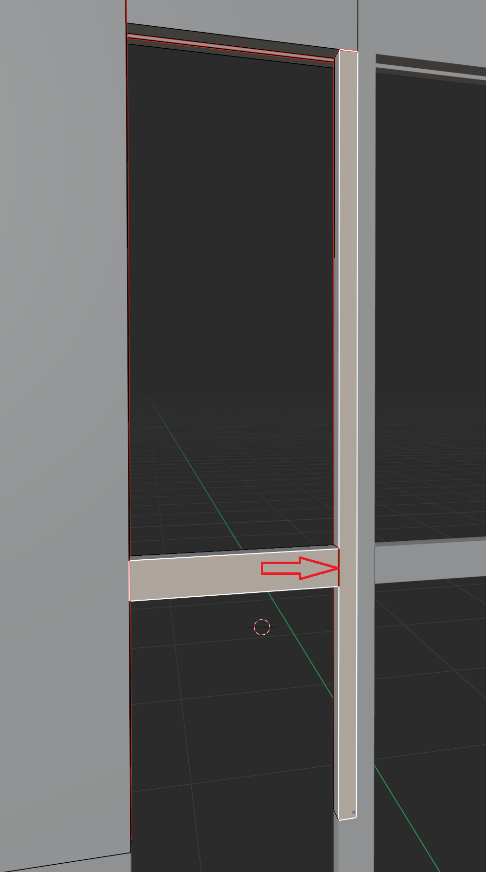

            Now to the big one: A single face on the front, which needs to be cut up some more:

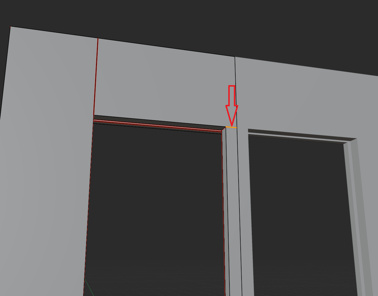

            First you need another edge to separate the vertical muntin from the rail. You can do that easily in front view with the knife tool and constrain it to the x-axis. Then mark that newly created edge as seam:

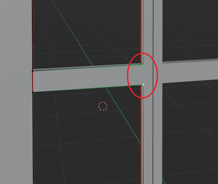

            Then there’s an edge on the front where the horizontal meets the vertical muntin, which isn’t connected to the faces. I’m not sure what happened there exactly (I assume f to fill?), but it doesn’t make two faces:
            You can delete that edge, then select the two vertices in the corners and press J to join them, this will cut up your face. Then mark the new edge as seam:

                I also discovered that the UV Sync Selection is nice for troubleshooting, but does NOT regenerate every time I change seam configuration in the model, which it probably should.
