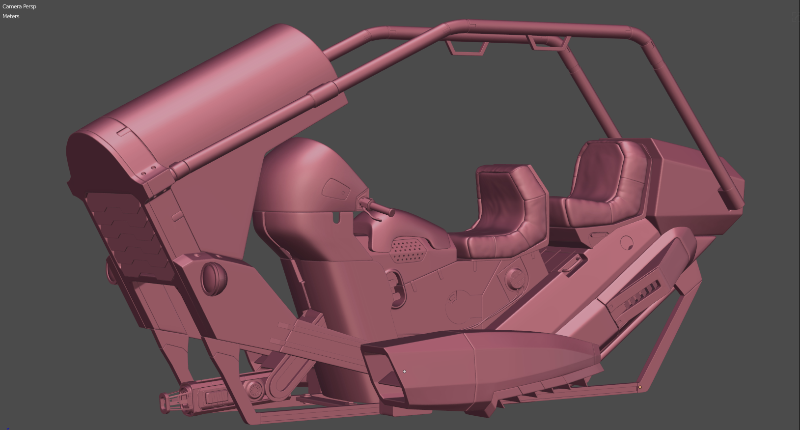

      @jlampel I have a question about the Blender-Substance texturing workflow that was not really related to one of the lectures of the course, so I thought I’d post it here.
      I want to render a shot of the this vehicle, but also some close-up shots so I’ll need a pretty high resolution since I’ll be rendering small parts in 1920×1080. I did some calculations and came to the conclusion that if I wanted to keep everything in one map and the same resolution the texture resolution would have maybe even have to be 32k, which is crazy high (especially for an average computer). Do you think giving the parts that will get a close-up render a seperate UV map with a higher resolution -comparable to UDIMs) would be a smart idea?
      Thanks in advance,
      Bauke
      #37570
      Jonathan Lampel
        Hey @baukepost , that model is looking good!
        Separate UV maps and textures is absolutely a good solution👍 Thankfully, UDIMs are coming to Blender shortly.

              Goose Gosling
                This is a sweet looking ride, love to see it textured when you’re done!
                #37575
                Bauke Post
                  @n3b Thanks, I’ve used Substance seriously only once on this drone thing from a year ago (and it doesn’t look that great), so it will definitely be a challenge texturing this big asset nicely.
