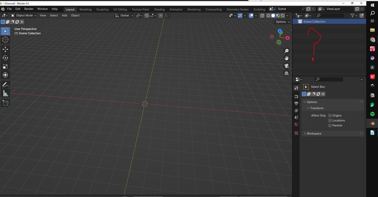

      Now in my testing I have unlinked All objects (lots of cubes) from all the collections. Now the objects are not in the 3D view, nor in the Outliner… where are the objects? How do I show them again and link them back to a collection?

        Can you post a screen? I sounds as if they were deleted
        #82530
        megaener
          I was just practicing the multiple collection nesting. When he said you can unlink. I went ahead and unlinked ALL my cubes. Just to see what happened they all disappeared from the 3D view and the outliner. I did not leave them linked to Any collections. And they’re simply gone.
          Also, I just added a new Cube (SHIFT+A > Mesh> Cube), then I just unlinked it from the outliner. GONE!
          #82531
          Dwayne Savage
            They are orphan data now. Which means they will be clean out of the blend file unless you have them assigned to a fake user(Shield icon) in the outliner the second icon from the left is the display mode dropdown. click it and select orphan data. you will will see brushes which is always there. and meshes. expand and you will see the cubes. If you directly unlinked them I don’t think you can get them back.  If you unlinked the collection you can switch display mode to blend file. Then under collections right click on the collection and click link to scene.
