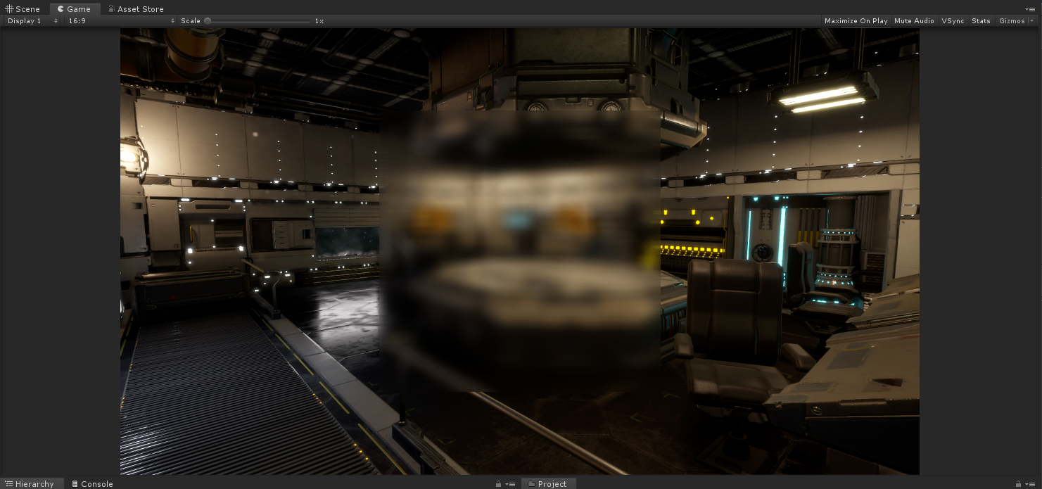

                Your best bet is a custom shader. A blurry image overlay could possibly work, but you’re stuck with the blur effect of that image. With a custom shader you can control how blurry it gets and possibly even create a blur in and blur out effect through scripting.
                I found this blur shader online and was able to get it to work with the UI image component which will work for what you want. It comes from here: https://forum.unity.com/threads/solved-dynamic-blurred-background-on-ui.345083/#post-2853442

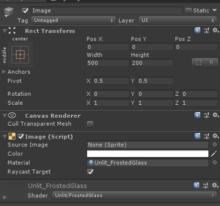

                Create a new unlit shader (Create > Shader > Unlit Shader) then open it up and copy the above shader code and replace everything in the file you created. Save it and now you have the shader. Right click on the shader itself in the project and create a material (Create > Material). This will create a material with that blur shader.
                Next you’ll need to apply this to an empty image component with the UI system. You’ll assign the material you created to the image component as such:
                Note this should not have an actual image for the source image slot. It’s just the blur effect. Here is an example of this working:
                Let me know if you need me to clarify anything or you’re looking for something else.

                    @blanchsb Hah, I had that as an image. Initially it was just a blank skybox which could’ve worked but I figured this was way easier to see.
