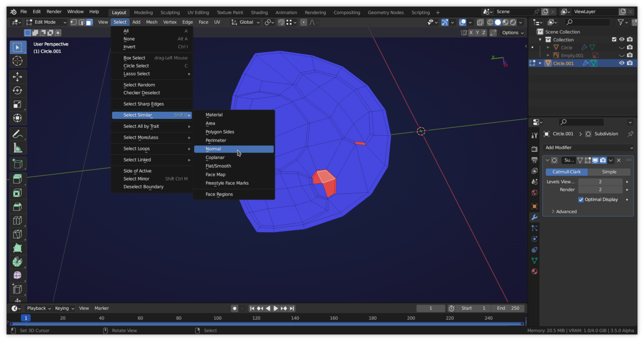

                Don’t select everything, select one red (incorrect Normal) Face and then Select Similar > Normal:
                Then you’ll have only all the red Faces Selected and you can use ALT+N > Flip.
                Thanks to @blanchsb for this tip!
