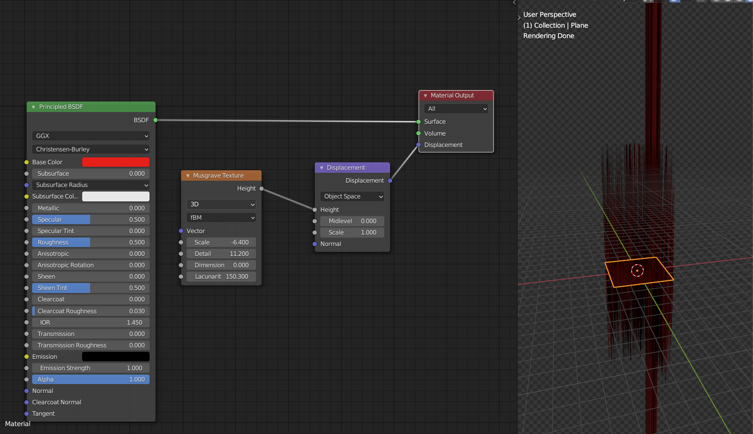

              #70461
                @glenng910  am not sure what you are trying to do here, but a few remarks:
                usually you plug a Mask into the Fac socket of something (often a Color > MixRGB Node).
                Did you want to plug in the Voronoi?
                You probably do not want to use Multiply though, because the Musgrave Texture produces negative values and multipying a Color with zero or less, results in black. (Negative colors are represented as black and you are inserting a Value, in this case called Height, into a yellow socket, which means that  that value is inserted into each RGB channel…)
                When using a Mask, you usually wnat to use a MixRGB (set to Mix!).
                But a Musgrave Texture is the most unintuitive procedural texture that exists…think of it as a ‘landscape’ with high mountains and parts that are below sea-level…but it can go completely crazy:
                I do not know of any advanced user who knows what the Musgrave Texture will look like with certain values 😉
