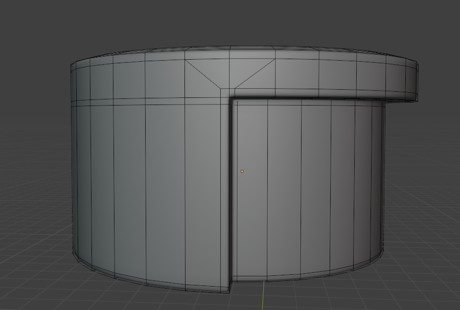

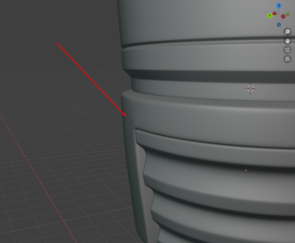

    Hey! I’m following the tutorial bit by bit (loving it so far). Reached face modelling chapter recently and noticed some issues with the head. To be short, I decied to go for another form for the head, just for a practice purpose. I’ll attach screens with a stretching and my topology. Should I leave it as it is or there is a better way to do this? I’m kinda stuck)

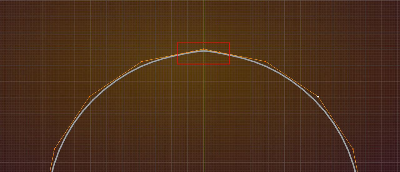

      Hi @CupOfTea ,
      You have run into a problem that is typical in Subsurf Modeling; basically, you have a circle with evenly distributed Vertices at the top, but below you have extra Vertices (Edges) that create something like this, when Subdivided:
      You can try to use the Data Transfer trick to fix, or at least improve the Shading in that area. You should maybe also consider, how this is going to be Textured. If you stick to something rusty like in the Course, you can probably get away with minor Shading issues like this.

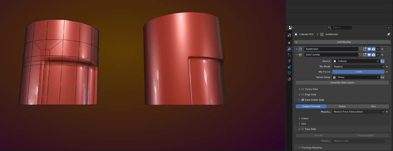

      #98310
        Here’s what you can get with a Data Transfer:
        Pretty decent, right?

        Charles
          Unless I’m misunderstanding your topology is different Martin. You have all quads and even spacing whereas OP had tighter edge loop and a triangle on the corner.

            That is true Charles @thehomme ,
            but that is irrelevant in this case, where I just wanted to show the effect of the Data Transfer.
            #98313
              In the course, JL uses the data transfer trick one or two times, so you’ll also see him do it. That pinching on the side is super common and practically can’t be avoided. There was a video where it was either Kent or JL that went into explaining the reasons why it happens. I think it was Kent, man if I could only remember where it was…. something about a negative space, ah man. But yeah, it’s super common so don’t worry too much.
              #98314
              Thank you all for the replies) I believe Data Transfer was used in the pot making video. That was so long ago for me I totally forgot about that trick
