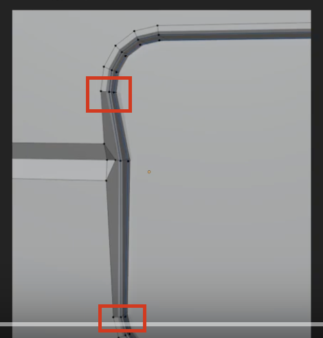

      My device did not come out exactly like his which is fine in the long run but after the 13 min mark when he talks about merging points, I think I did 2 of my buttons differently then he did somehow and I am not sure if it’s a easy fix or if I should work with what I got. Also I managed to save one side panel fixing it but the other looks like its bending some if I could have some advice on what to do for my points and if there’s anything else I should know before moving on thanks! Also I am not sure if there is a picture button I am missing here, drag and drop does not seem to be a option in the text field so I just made a youtube video for this time.
      #79058

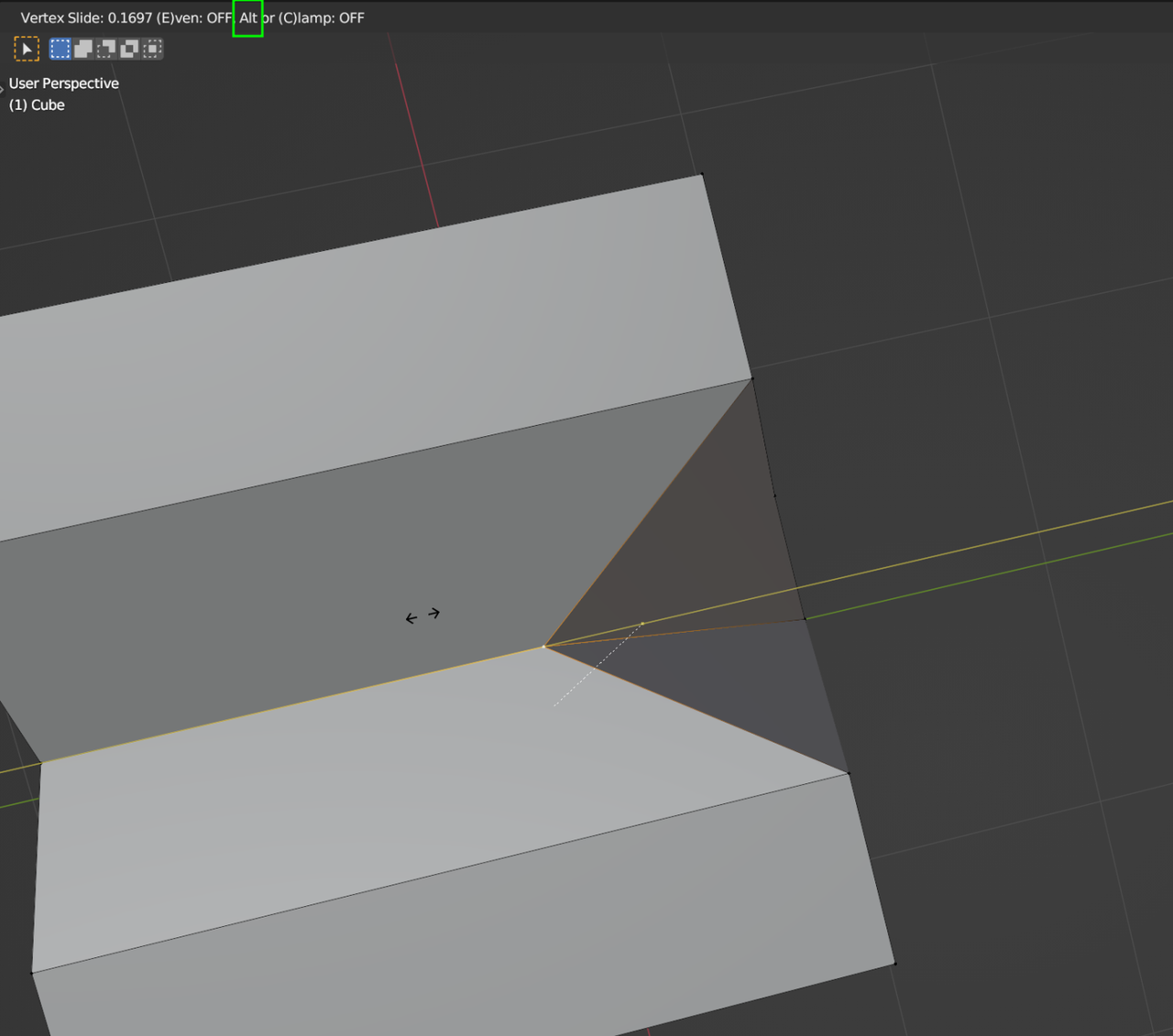

        Hi Brandon,
        I think most of those Button issues can be solved by Merge at First (or Last) instead of by Distance.
        The right Button in the Buttons2 image, you can maybe use G,G to go into Vertex Slide and then press and hold ALT to turn of the Clamping:
        That lft side of the Panel needs to be fixed, but it’s hard to tell what the easiest way is, (it depends on exactlywhich Vertices are wrong….)
        Maybe you can mirror the right side over to the left somehow…or moving the top left corner to the right and use Vertex Snapping to get them in the right place….time to get creative, (or start over…)

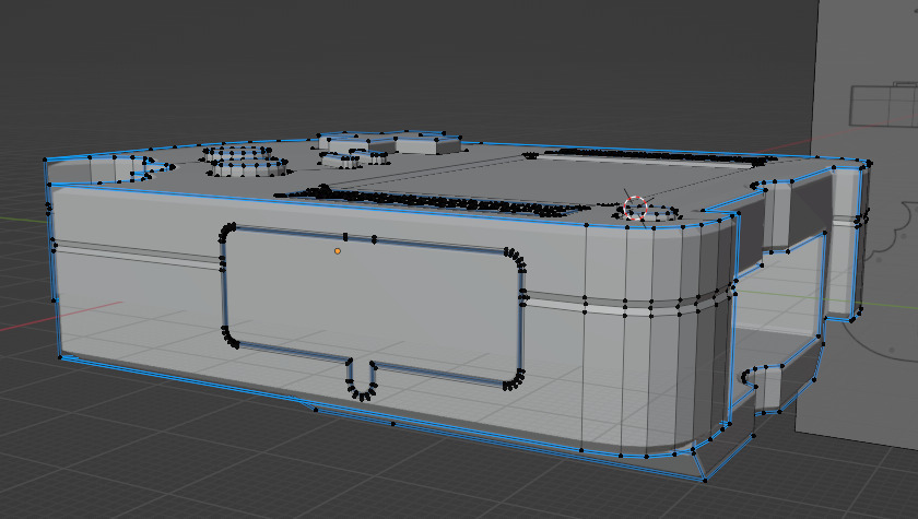

            Brandon
              I actually just moved the edge in the very middle on the left side of the panel out more on the y axis and that seems to have fixed it even more, but will take more tips! panel1683863245.jpeg

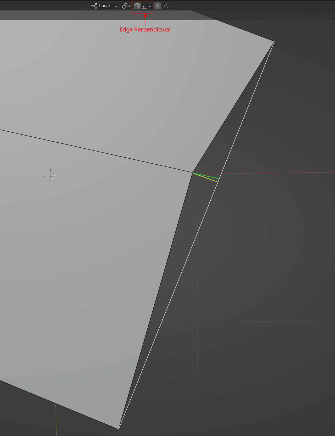

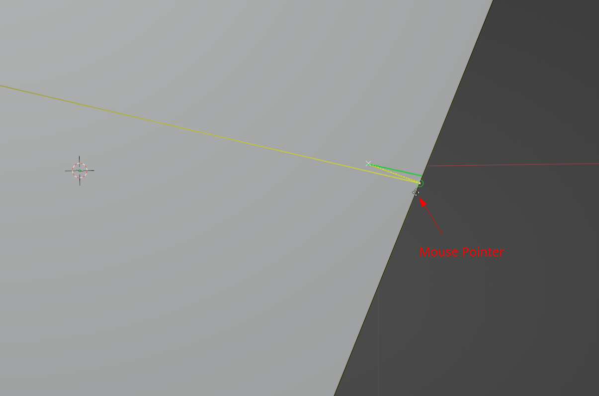

                  Okay Brandon,

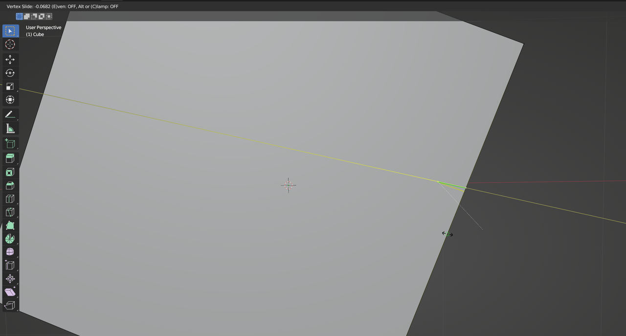

                  Some straightening tips and tricks for your toolbox. Usually, you can use S, Y (or the relevant Axis), 0 to get Verices in a straight line (use Active Element to control where they are ‘going to end up’).
                  Lets say you have a really unfortunate situation, where you have no relevant Axis, like here:
                  First make the white Edge by connecting the two Vertices with F.
                  Now, if you want to move the Vertex along the yellow line, set your Snapping to Edge Perpendicular and G, move the Vertex and holding CTRL (or enabling the magnet), hover your Mouse over the Edge, close to where the Vertex is supposed to snap to:
                  If you want to go along the green line, Enable Edge Snapping and then you can press G, G to enable Vertex Slide, make sure you slide along the corrrect Edge (to the left) and, holding ALT to disable Clamping, you can move to the right and hover over the Edge you created:
                  Hope this helps a bit (I recommend to practice the different ways and (bonus) see if you can come up with other methods).

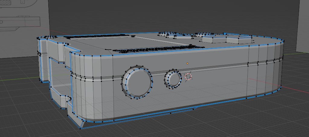

                        Brandon
                          ok so i am going faster this time staying up late but i will check in more this time but done for now! I do think things are straight now and I kind of know where I messed up when things were not straight with the whole device, pretty early on. ogres1683956883.jpeg
                          #79068
                            Awesome Brandon. It is always a good idea to start over, it might sound like a waste of time, but it is not. It is often faster to make a new model that it is to fix a crippled one. And added bonuses, you start to get the Neo view of The Matrix in that you know in advance what might go wrong, because you’ve already been down that path and your brain starts to see what to avoid before you start. You’ve just level up and gained The Neo Sight.
