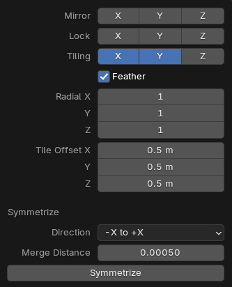

        Saurabh Singh
          You can adjust the tile offset. The setting is in the same place as the tiling setting.
