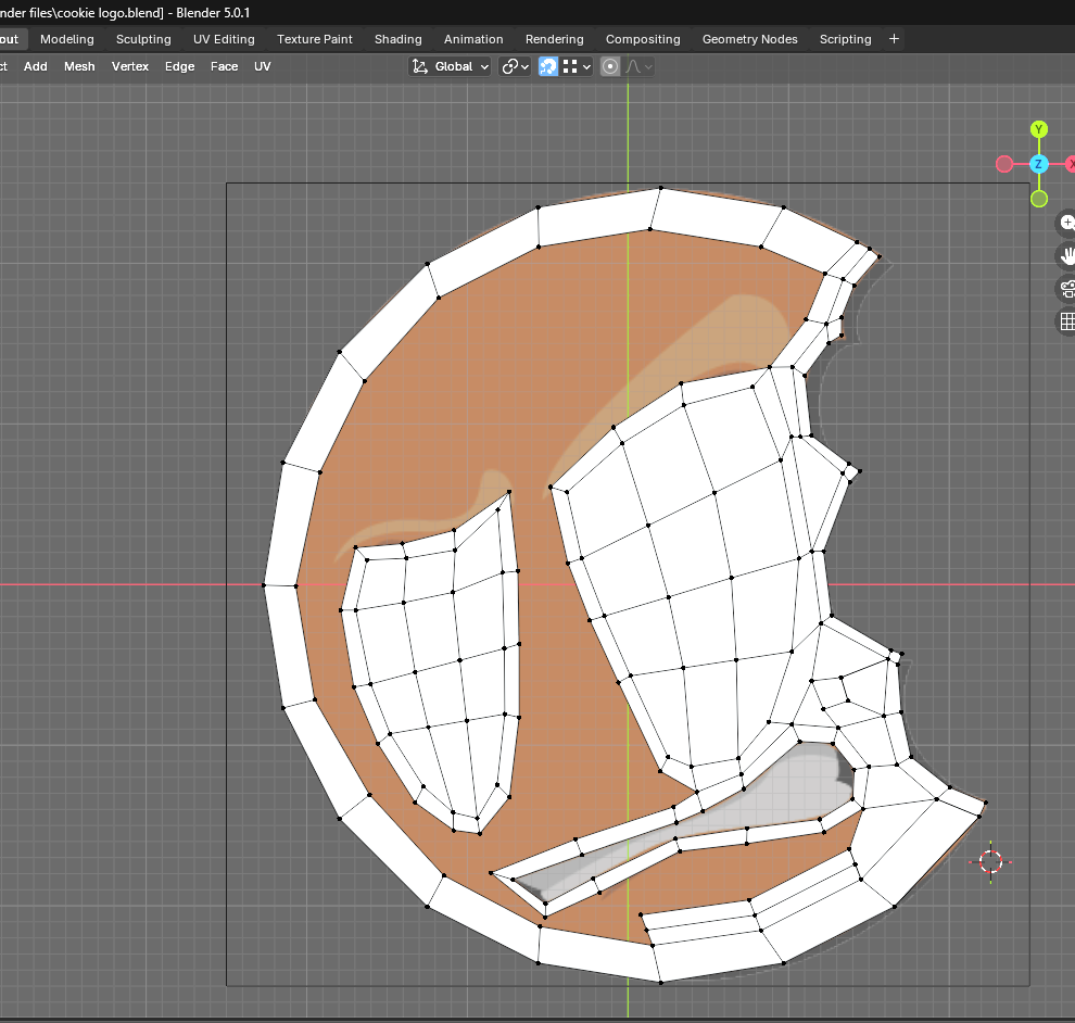

    Mr.Thicc NA
      if that’s not enough info or your not understanding ill try my best to explain
      #98943
        Hello. I’m not sure what you mean. You can follow along as JL does it in the video lesson and make the quads as he does it. Or you mean you don’t know which hotkeys is he using? Usually you select 4 vertices and F to fill with a face.
        #98944
          Hi Mr. Thicc @battlehorn5283battle ,
          You have too many Vertices in the ‘bitemarks’: Like here:
          Of course you still need to shift Vertices around a bit to make things prettier, but this is basically it.
          It is actually a good idea to start over from scratch, as unintuitive as that sounds. Watch the 3 videos for the Face Modeling irst and then again in bite sized pieces, following along.

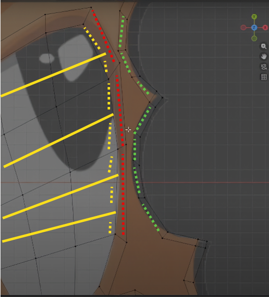

          #98945
          Charles
            It’s the classic dilemma – 7 green edges need to join to 3 red edges. You either reduce Green edges as Martin suggests or you add to red as below shown in yellow. Note. I’ve over simplified here to show 7 edges to 7 edges but they don’t have to actually match… you see in Martins example he’s resolved 2 edges to 1 edge. Being able to reduce or increase the edges across your model is the key skill which takes a lot of time and patience to develop
            The rule of thumb is the minimum number of verts to get the shape you want. So Martins approach is more optimal / best practice as with sub d you only need a few verts to get smooth curves. You have so many you could probably leave this low poly (no sub-d) and it’d still look pretty smooth once zoomed out to show the whole logo.
            #98946
            Mr.Thicc NA
              I’m not sure if i should create a new post or not but its mostly related. I got the vertex count to be the same but i cant figure out what i did wrong/ different for the spot above they mouth and under the eye to be like his I been trying to not ask but its been a few days and I’m not able to pin point what i need to change

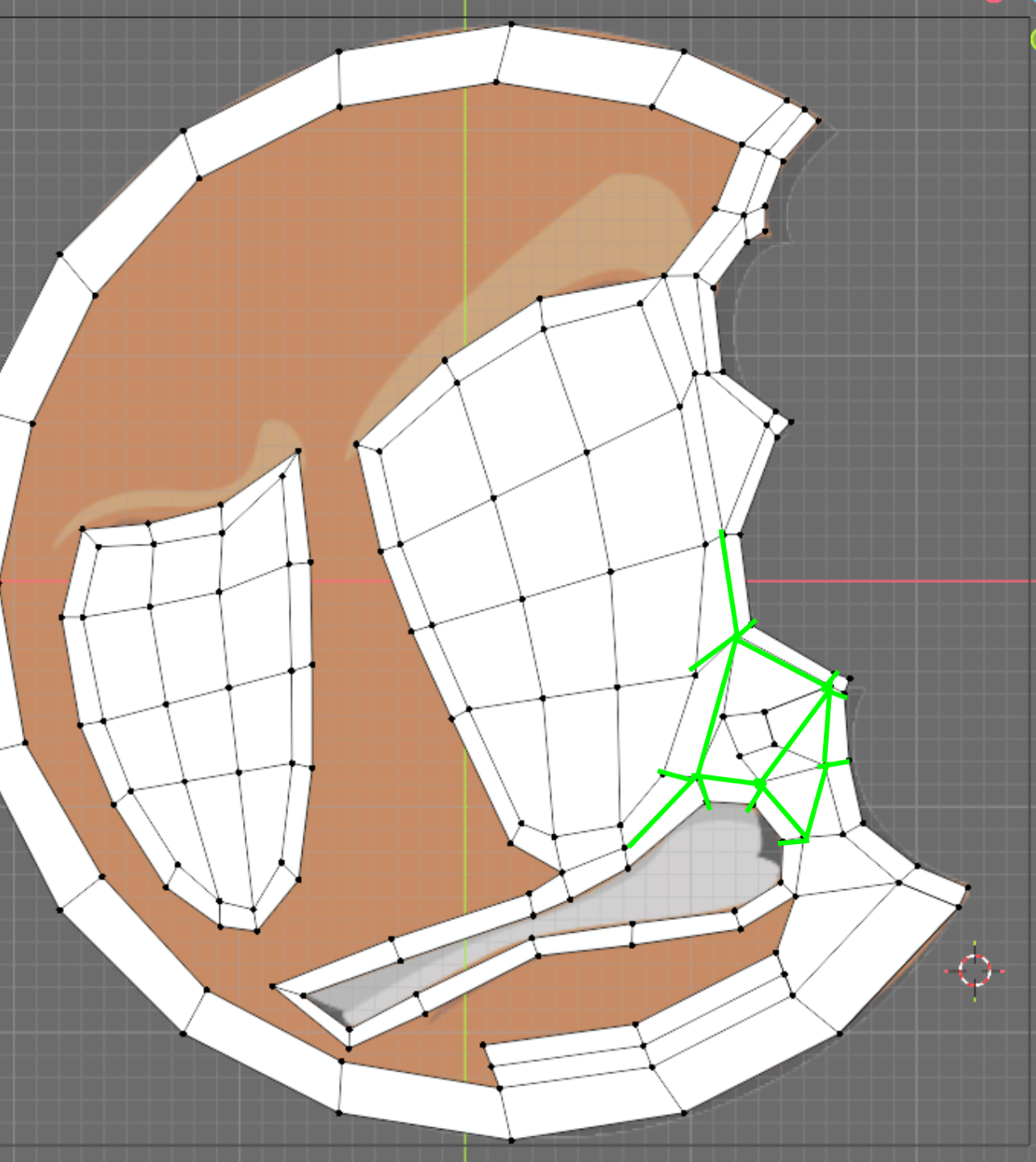

              #98947
                Hi Mr Thicc,
                It’s basically here, where you ‘messed up’:
                You’ll obviously have to move some Vertices around to make it a bit more even, but that’s it.
