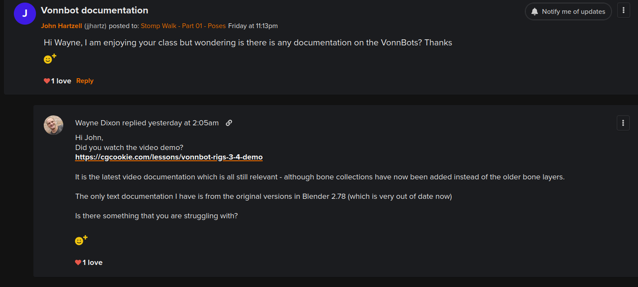

          Hi John,
          “I asked if there was any documentation but got no response…”
          #94293
            Wayne is such a master that even when he didn’t answer he answered.
