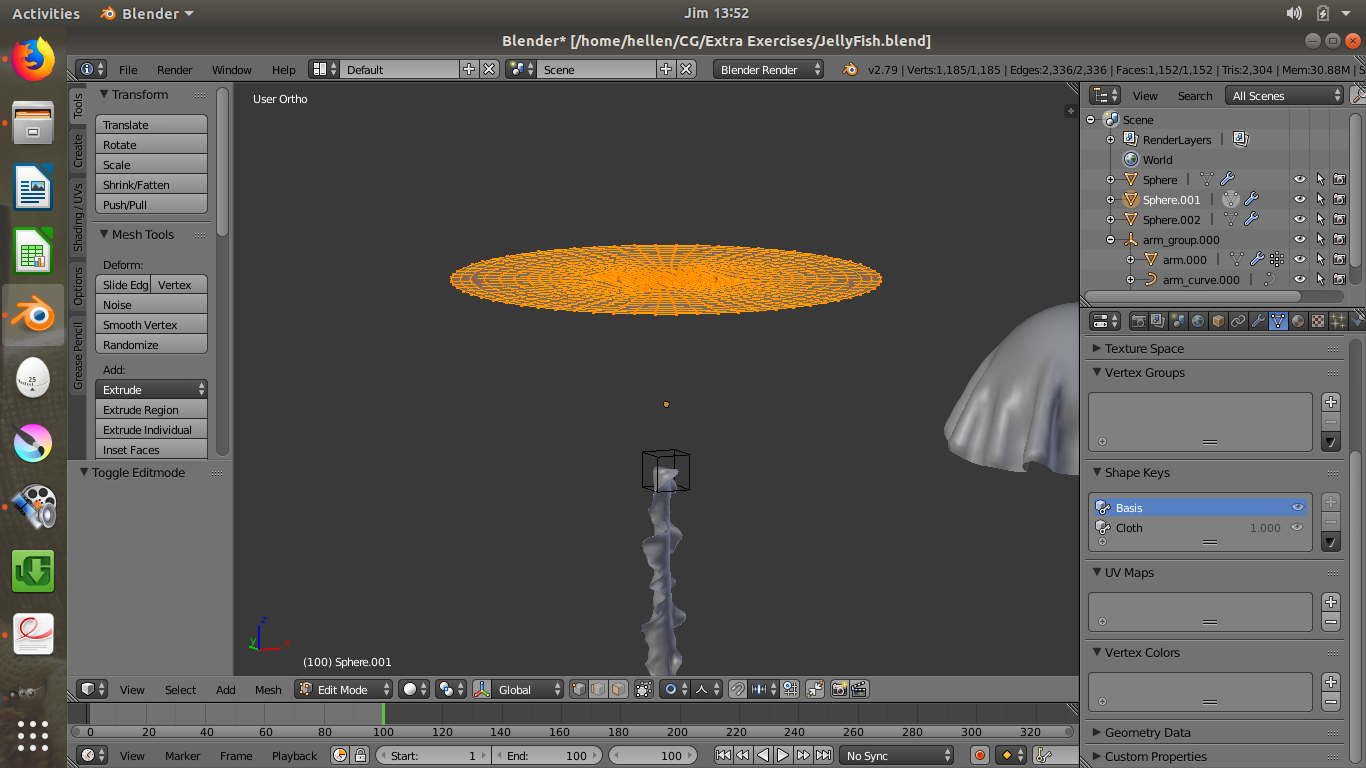

      The bell is reverting back to a flat surface once I hit edit mode. I’ve redone the previous step a couple of times, just in case I missed something but still the same result once I hit edit mode. Is there something that I’m missing?
      #28766
        That’s because you have the “Basis” shapekey selected. If you switch to the “Cloth” shapkey, you’ll be able to edit as expected.
        You can see this at 5:00 in the video.
        #28767
        ciku-karugi
          Yep, that was it. Thanks Kent!
