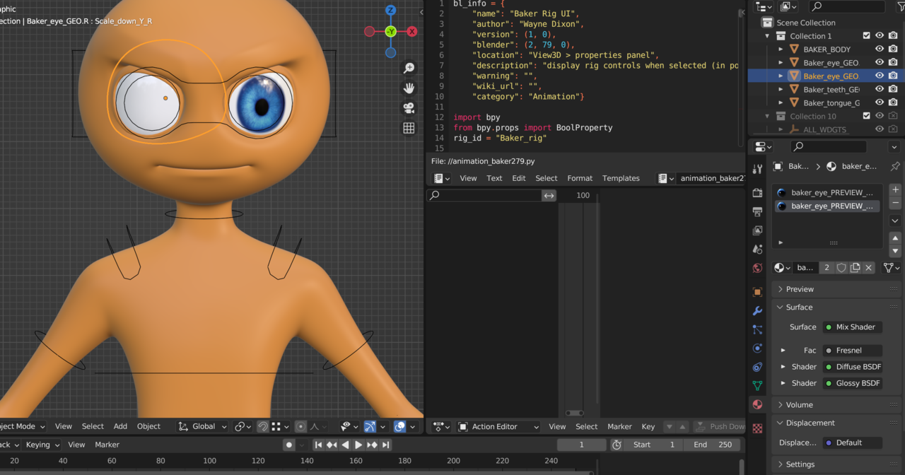

Hey @Sabina Frolova, I had this issue some time ago, I can’t remember off the top of my head what the solution was. Let me take another look and I will get back to you!

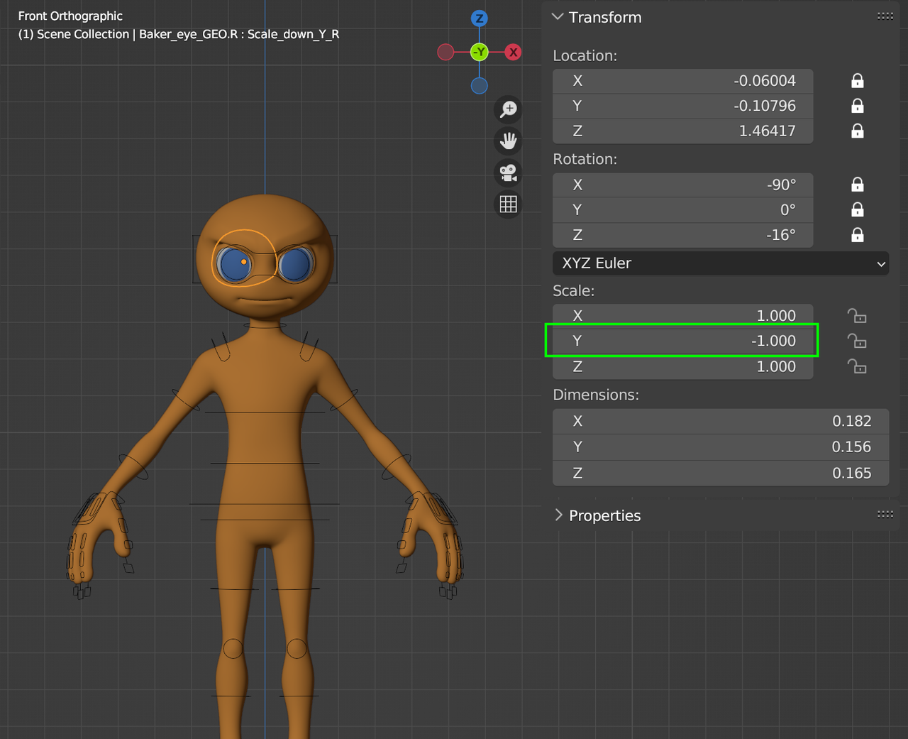

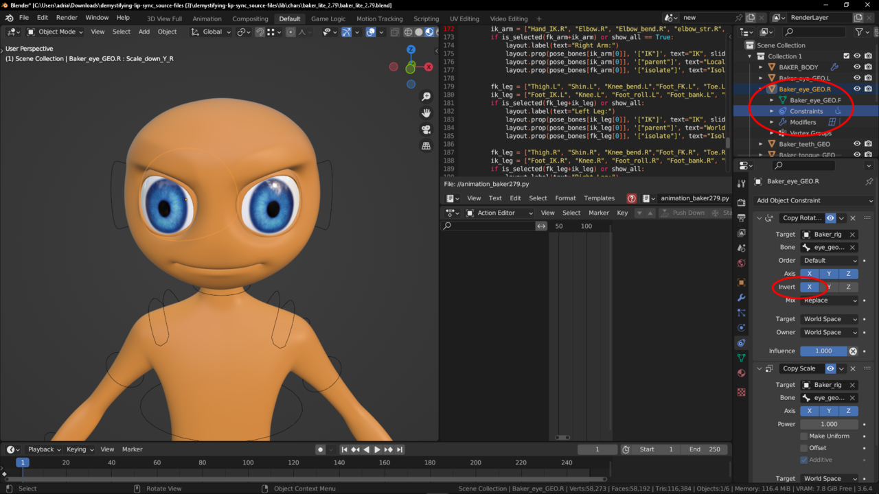

@Sabina Frolova The iris is facing inside the head. Select the right eye, go to the Object Constraints and on the Copy Rotation constraint, enable invert for the X axis.
