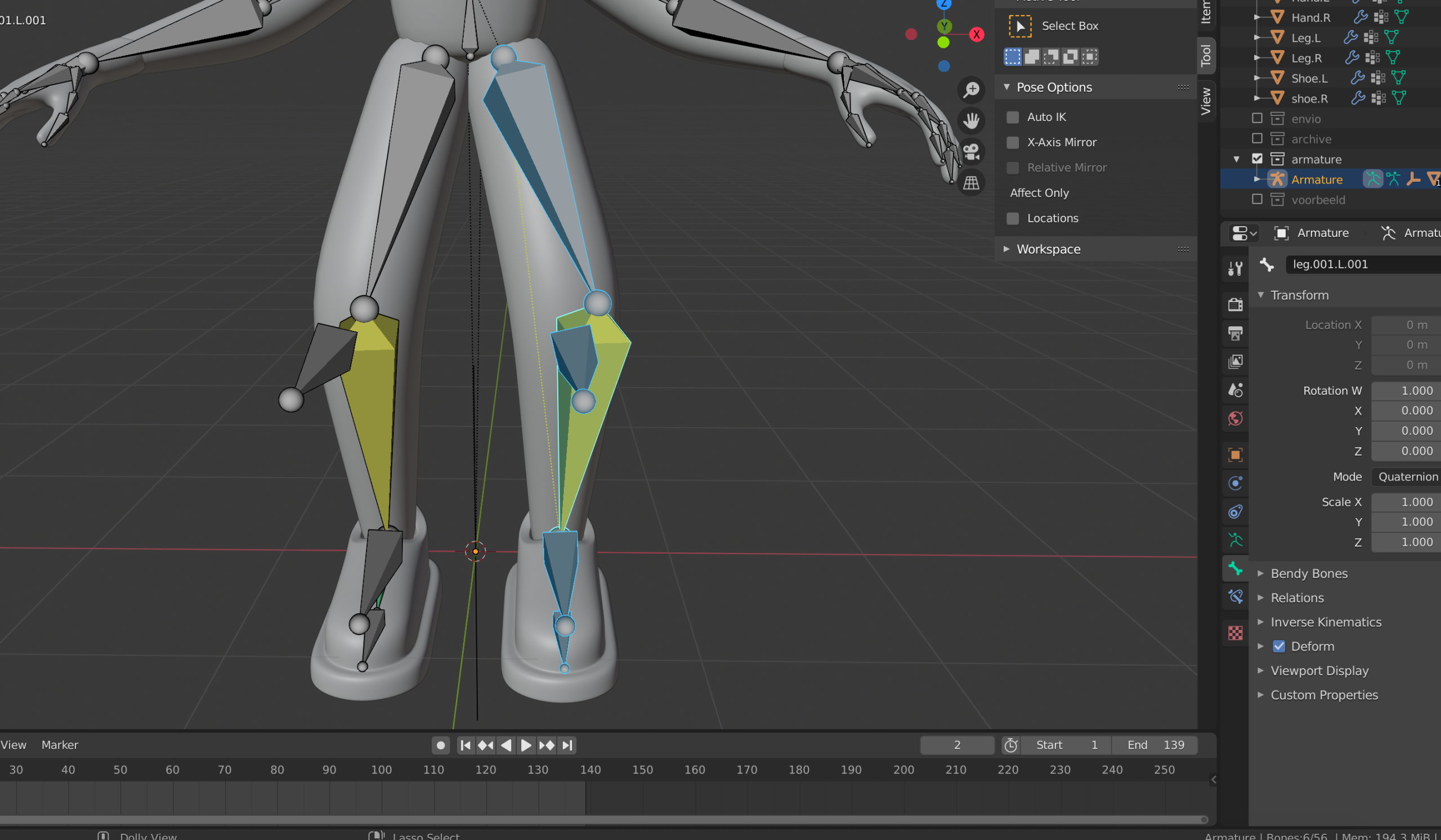

      Hey,
      I copied the situation from the video. everything works perfectly until I mirror the bones with IK constrain. Everything is correct but the knee is further out. what am i missing? thanks.
      #53726
        You need to adjust the Pole Angle in the IK constraint settings:
        Often I find with situations like this that the pole angle needs to be adjusted by 90-degree increments (90, 180, 270) but you can adjust it manually as desired.
        #53727
        gregvanstaey
          thanks for your fast reaction!!
          i have solved the problem
