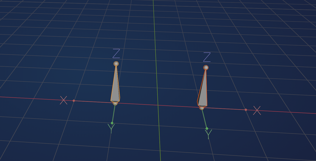

      For this exercise, everything is working as expected rig-wise. However, I found the symmetrize results a little confusing in terms of the bone roll values. It looks like the symmetrize affected multiple axes, instead of just flipping across one. I would have thought that the bones’ z-axes would be facing each other (mirrored) while the x-axes would point in the same direction (forward towards the knee poles). However, the x-axes are pointing opposite each other. Any ideas why this happened? I’m not sure if it’s something that would need to be fixed or if I made an error somewhere during the rig setup. The IK settings seem to have compensated with the Pole Angle automatically.
      Screenshot of Symmetrize Results

        Hi @TheRavensCurio,
        What you seem to expect, is that by Symmetrizing, the Orientation of the mirrored Bones would change (from right-handed to left-handed, or the other way around):
        That would really be unwanted.

          Thanks for the response, Martin! I’m not sure I understand entirely. I’m guessing that the way the symmetrize worked was correct and produced the expected result. However, can you expand upon why the orientation change from left-handed to right-handed would be bad in this scenario? Is it an issue of negative scales, or something else?
          #96267
            We’d have to ask someone with more practical experience, I guess…for me it’s like a gut-feeling; something like inconsistent Normals in a Mesh.
            In the screenshot I provided, I indeed made 2 Armatures, one Scaled negative 1 0n the X-Axis. But, bad as that would be, to have something like that in 1 Armature? My bones ache, when I try to imagine something like that 😱

              So Symmetry Flips the roll. Thus negative becomes positive and positive becomes negative. That is way the Axis are flipped. On the pole target, the bones with the IK constraints(the first in the chain) will have it’s X axis point towards the pole target. In this rig the main control/Bend axis is z. Thus you need to change the Roll. If you wanted to use X as the main bend axis then you would set the roll to so that X runs across the the knee instead the Z axis. Then you would use the Pole Angle to position it back after it twist to point the X at the pole target. They are used for different things.

                Then it’s better not to have those other bones shift between edit mode and pose mode.  For example, you might have the DEF bone x axis pointing left, but the constraint will then make it twist around to follow you IK bone.

                When you symmetrize a mesh object – 1 side is pretty much scale by -1 over the x axis.
                However, with bones, they have x,y,z axes that always need to stay in the same relationship to each other.  What is this relationship?
                You heard Martin mention the left handed and right handed coordinate system.  Well this is a mathematical term for which direction is +x, +y, and +z.
                (Blender -like many other softwares- is right handed).
                What makes it right handed?
                Make a finger gun with your right hand.
                Thumb is up, pointer finger is forward.  Now stick out your middle finger in the 3rd direction.
                The direction your fingers are pointing with your right hand – are the positive directions.
                (There’s more to this but for simplicity we can leave that explanation there)
                 Why isn’t it as simple as scaling the x axis by -1?
                That would change it from right handed to left handed.  This breaks everything.
                What is bone roll?
                Bone roll goes from -180 to +180, and it’s really just a way for riggers to adjust the orientation of an edit bone in the UI.
                Under the hood, Blender uses this value to construct the bone’s orientation matrix.
                It’s a fancy way of saying, “it’s the simplest way for humans to point the bone where you want, but Blender is going to crunch the mathematical numbers for you”
                That’s great that Blender dumbs it down for us.
                However, it means that you simply can’t just flip the value of a Bone Roll in order to symmetrize it.  This would change it from right handed to left handed – which breaks everything.  It needs to be recalculated in the same coordinate system, just pointing in the mirrored direction.
                TL;DR
                So how does Symmetrize work?
                Here’s the easy explanation.
                The position of the head and the tail of the bones are mirrored across the x axis.
                And the bone roll is recalculated to point in the mirrored direction.
