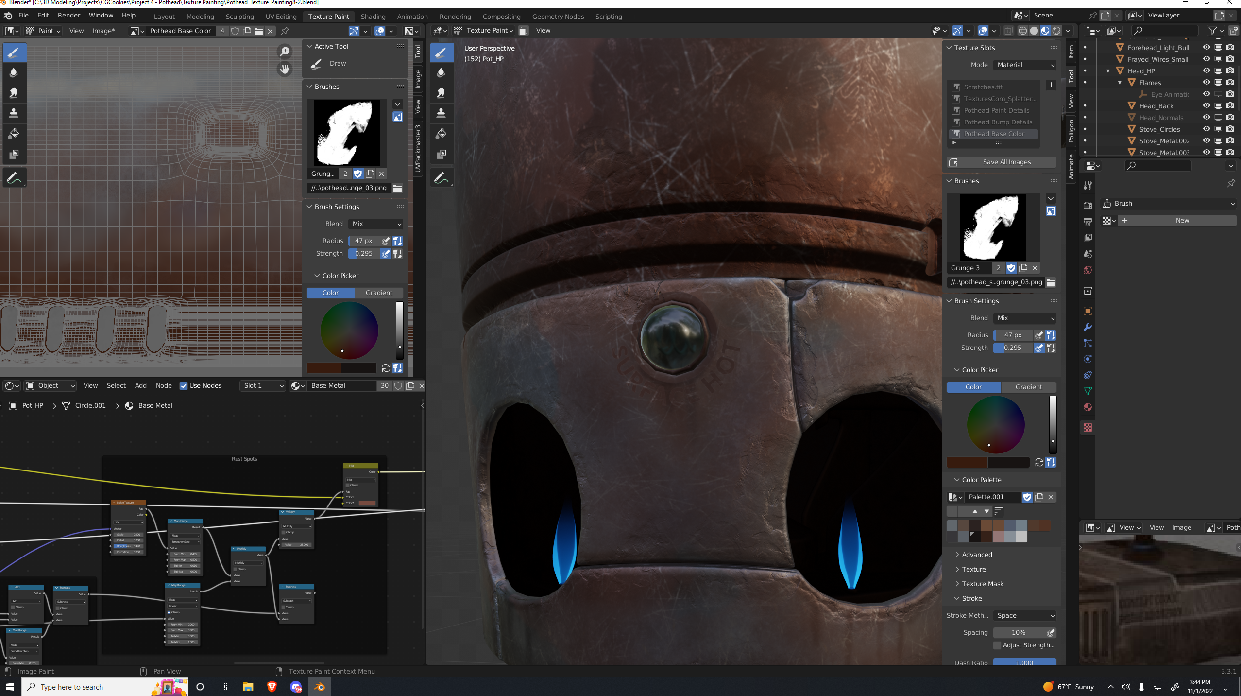

      Greetings CGCookies,
      I have a question about the stamp painting we did in this lesson. I have painted the “Surface Hot” text but, it seems to be under(over?) the area where the rust spots are procedurally added. I see an outline for the text but the black coloring is not showing. I have tried changing the size/pattern of the rust so that it would be placed in a different area (so as not to overlap the text area) but, I would like to know if there is a way to have this text appear over the rust.
      I appreciate the advice,
      Richard

        Hard to say from that screenshot alone @Kno0ne ,
        It could be a mistake in your Shader Node Tree, or maybe you painted with the wrong Brush or Color, or…
        If you could provide a link to your .blend file, we might be able to troubleshoot why it’s not working as expected.

          I think my stamp is also under the rust layer, but if you’d like to move it so that it’s more visible, you could mix it in after the rust. You can think of each mix node like a layer, and instead of moving it up a layer like in Photoshop, you can move it to the right and mix it after the rust ‘layer’.
          #75985
            Yes, there is a way for the text to appear over the rust. In the order of the nodes, you need to put it after the rust so it appears on top. I agree, most likely the problem is in the order the nodes are in your shader. It’s hard to tell so as Spikey says, if you could share the .blend we could take a look.

                That is excellent @Kno0ne ,
                I think the problem is with the highlighted MixRGB Node, you have set it to Mix, which makes it blend in with the second color, more when the Factor gets higher. As the text is quite dark, I would suggest setting it to Multiply:
                And yes, your Mix Node looks a bit different, but I am using 3.4…that is what it will look like in the future.

                Richard Schweda
                  Right on! That makes sense, thank you very much.
