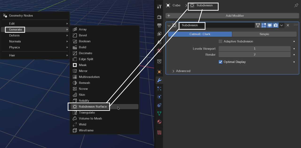

      Hola! This might be a small thing. I’m currently using Blender 4.2.9 LTS and I am wondering if there is a difference between the two. I can’t seem to find subdvision in my modifiers. Just subdivision surface.
      #95055
        Hello Sam. Yeah, Subdivision Surface is sometimes called subdivision on SubD for short. It’s just that after you add the modifier, it says subdivision on the title once it’s on the stack.
        #95056
          Indeed, like Omar says:

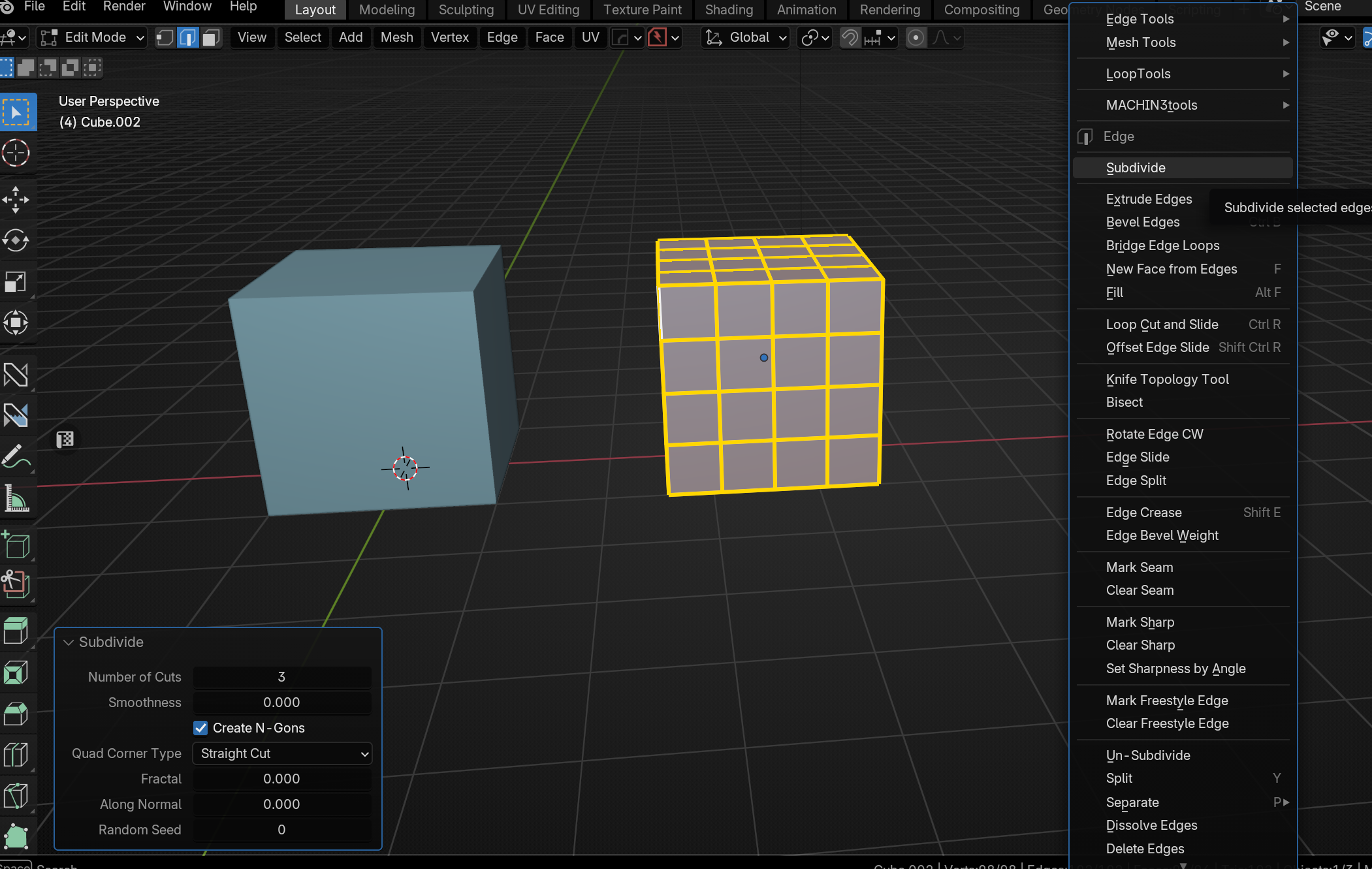

              Yeah, there is a destructive subdivision you can do in Edit Mode. This is where you can Subdivide the mesh into editable verts, edges.
              The subdivided Surface modifier adds more geometry but in a non-destructive way, where you cannot edit the extra geometry added and it makes the model file not as big as a destructive subdivided model would. Also a Subdivide Surface modifier will adjust to changes to the model easier than a non-destructive Subdivide, where you’d have to modify the mesh a lot more which could be a major chore if you have a dense mesh.
              Here is a pic of the destructive subdivide cube with the Subdivide menu on the lower left and the left click menu while in Edit mode.
              You probably already know this already, I’m kinda late in adding anything. just thought I’d add the Subdivide option in edit mode in case that was what you were referring to as Subdivision.
