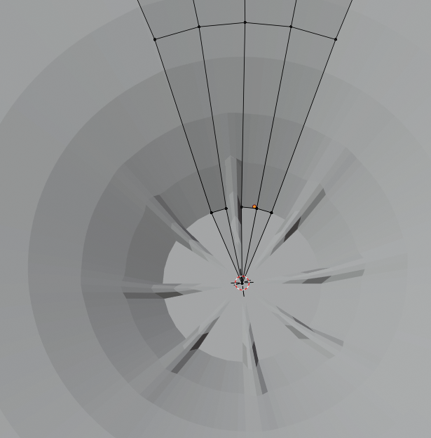

      Hello, it seems like the subdivision surface modifier wants to create some weird geometry in the center of my wheel, i don’t know how to fix it, can someone help me ?

        recreating the central point got rid of the issue,

          Good to see you’ve managed to fix it. For future reference, whenever subdiv gives you weird results check for the following :
          – Multiple vertices on top of one another. Select all your verts –> alt+m –> merge by distance to see if that fixes it
          – The normals on your faces. Turn on backface culling and/or select your model and shift + N / shift+ctrl+n to recalculate / flip your normals.
          – Interior faces
          – Check the sort order / individual settings of your modifiers
          #50848
          songo
            it was probably the normals in this case, i haven’t checked it, Thank you
