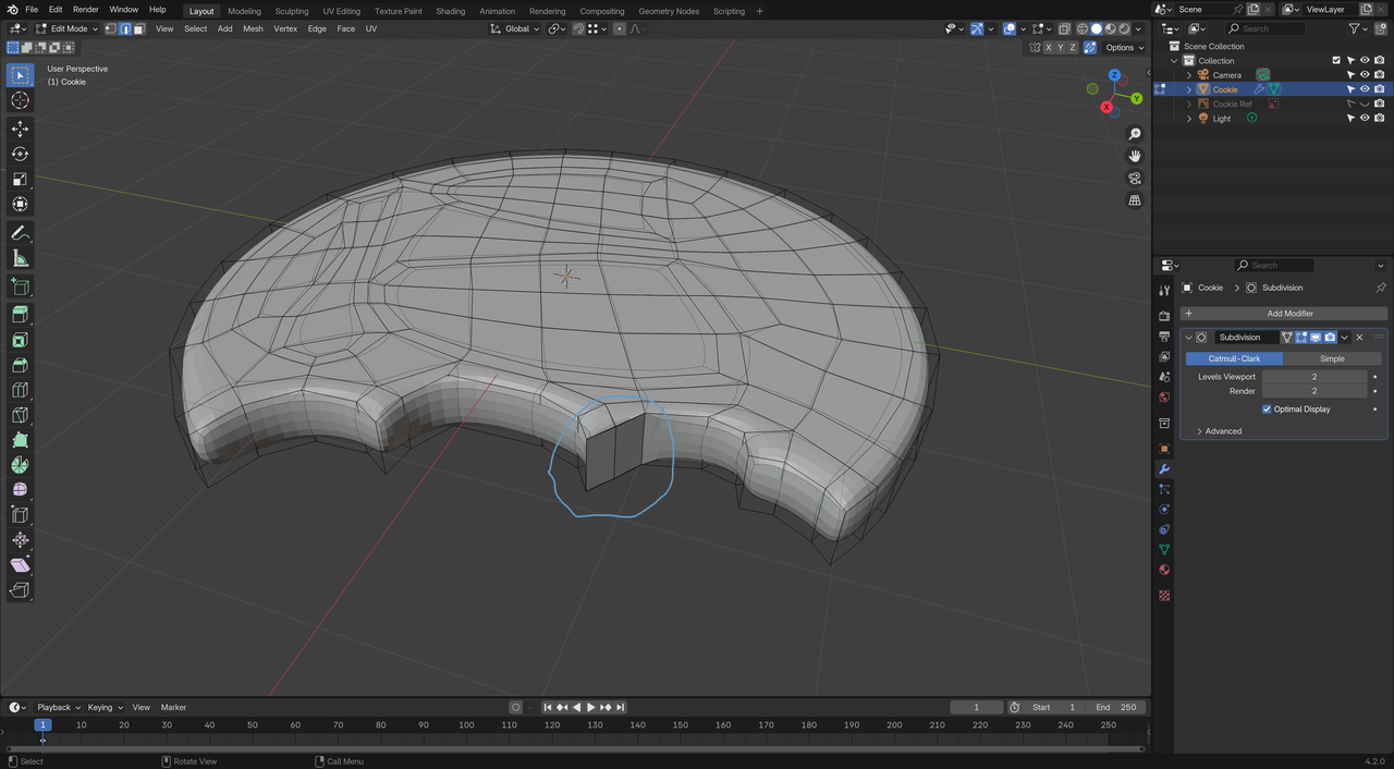

      Odd one here (the problem, not me). After adding a sub-division to my cookie, a couple of edges are still sharp. Any ideas folks?cookie13.png

        I think you have to recalculate this face here Do you check the Face Orientation? You can activate this option here (see image).
        If faces are red, they must be recalculated. To do this you have to go to Edit Mode -> Face Mode -> select all faces or only those that are red and then ALT + N.
        If it is only one face, flip option is sufficient, if several are affected, use the recalculate functions.

        Roger Corbett
          #90656
          Roger Corbett
            A combination of edges I couldn’t work out. I tried deleting them in every combination possible but I was left with edges and no faces. So, I deleted them and created a two more faces to complete the shape. Sorted! Thanks Leo.cookieSolution.png
