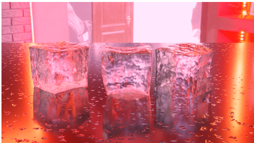

      Hallo dear community
      Having an issue that although I can make the Water drops on my surface,
      but can not manage to put them in a certain spot, in that case closer to
      the ice cubes. I would like to have the surrounded area blank.
      I know it can be done with the nodes eg some math trick… or colour ramp setting but just couldn’t figure it out.
      anybody out there who knows that? I wanna do it this way because of a learning process… no texture or uv unwrap.

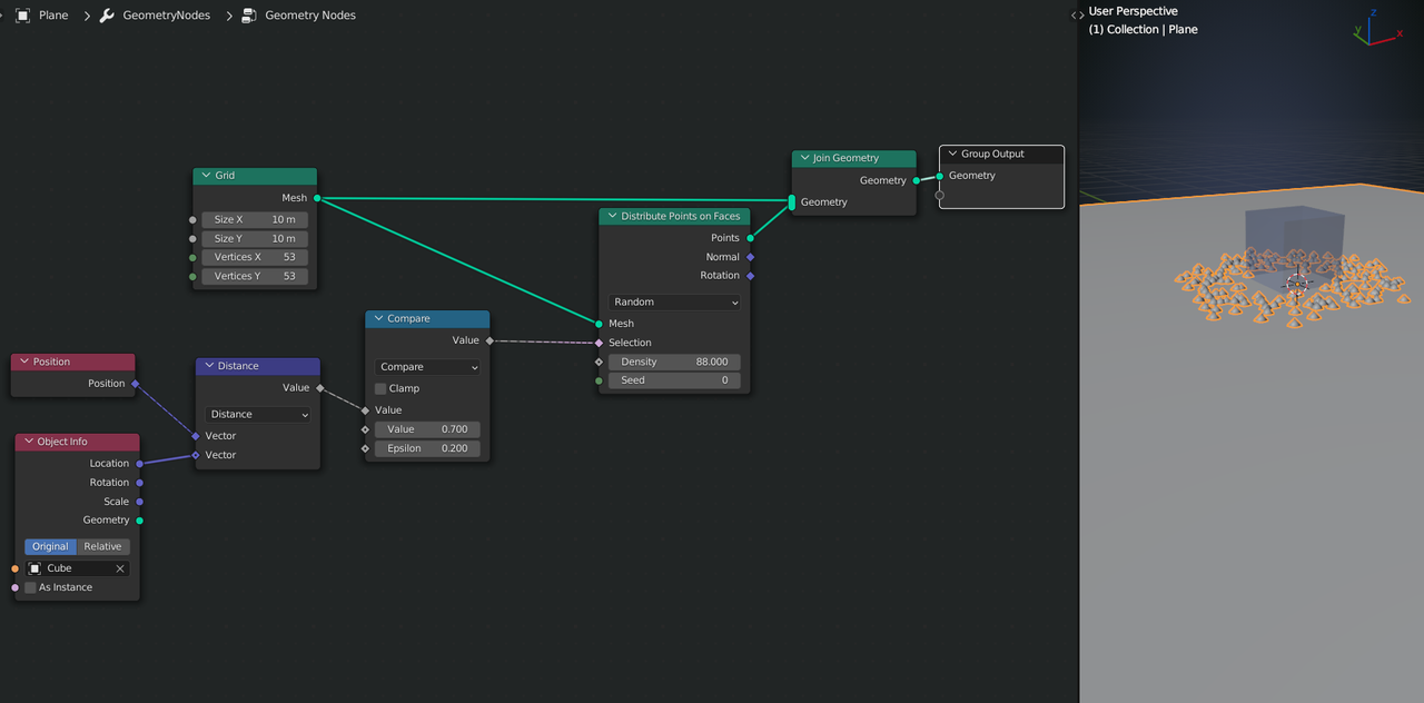

            Of course a more obvious choice would be to use Geometry Nodes for this.
            I haven’t been using it lately, but a simple setup like this already gets you close:
            You have to use a Object Info Node for each cube, because it calculates the distance to the Origin of the Object.
