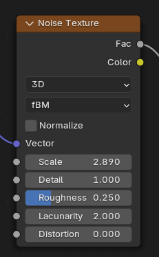

      When I add the Noise Texture to the Principled Volume (10:30), there’s a very consistent pattern in the clouds. It’s almost like a checkered pattern. I ran some tests and it doesn’t occur when running the Principled Volume into the Surface connection on the Material Output, only when attached to the Volume output.
      I’m using Blender 4.2.2 using the Musgrave workaround and have also tested it with 4.4 on a different computer. It yielded the same results no matter what I tried. I’ve searched quite a bit online, but haven’t found a solution to this particular problem.
      Any suggestions on how to fix this issue? Thank you in advance!

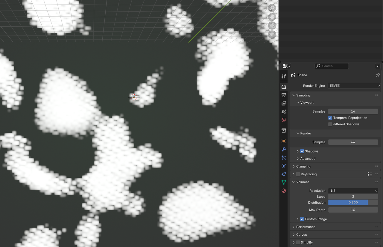

            My first guess would be, that it has to do with your Volume Settings in EEVEE, especially the Resolution and Steps.
            Here is what you get with Steps set to 2, for instance:
            An easy check is, to switch to Cycles and see how that looks.
            #95506
            jecho
              Thank you for the advice, Martin! Changing the Resolution & Steps definitely had an impact. Steps was set to 64 and I had to raise it to 128 for it to begin to improve. Switching the Resolution from 1:8 to 1:4 helped as well. Naturally, the FPS of playback slowed dramatically. When I tried it with Cycles, the pattern went away.

                    Hi @jecho ,
                    Those EEVEE Settings depend on the size of your Volume (and when using Object Coordinates, possibly also on whether or not you have Applied the Scale of your Volume Object).
                    This might not be correct, but I think of it like this: if you cover 1 meter, taking 10 steps, the steps are smaller, than when you take 10 steps and cover 100 meter.
                    Same with the Resolution; a 1080 p resolution will be more than enough on a phone screen, but wiould look terrible in a cinema.
                    And to answer your question: no, it shouldn’t matter what GPU you use (at least not for the EEVEE Settings…it will impact the Render times and if it’s ‘really old’, Cycles might not be able to Render with it and has to revert to CPU).
