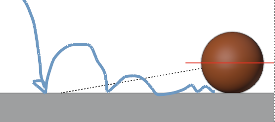

      I try to do the Bouncing Ball exercise (Fundamentals of Animation) and I get two strange things. First, the rigged ball seems attached by a dotted line. Why? Second, I can’t get only two keyframes: I get a line between them. Again: why?

          Hey! The yellow line between the keyframes indicates that the keyframed property has not change during that interval.
          And the dotted line, I think, could be indicating that the ball is parented and has moved from its parent origin? Something like that. It is a relationship line I think

            Hi Marie,
            Martin is correct.  The dotted line is called the ‘relationship line’.  You can disable this in the viewport overlays, however, it shows you the parent/child relationship.
            In this case it is the Body control that is a child of the Root bone.

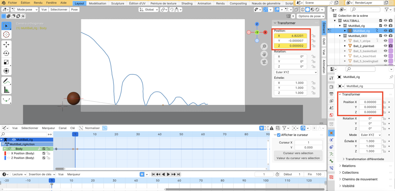

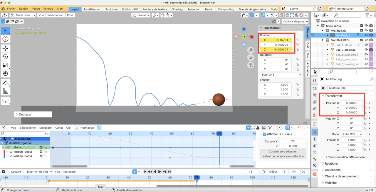

              Well, well, well… I need more help. I have listened again the lesson but I still get that result: the two keyframes have the same value, even if I’ve moved the ball. But I noticed that the values don’t change in the window at the right of the board. Look at my two screenshots:
              What have I done wrong???

                Nothing seems to be wrong.
                The X Position changes (red curve in the Graph Editor). The Z Position stays the same (blue line), because that hasn’t changed yet.
                Those Positions on the right, that stay at 0.000 for all three Axes, should not change…they show the position of the Rig, not the bones in Pose Mode.

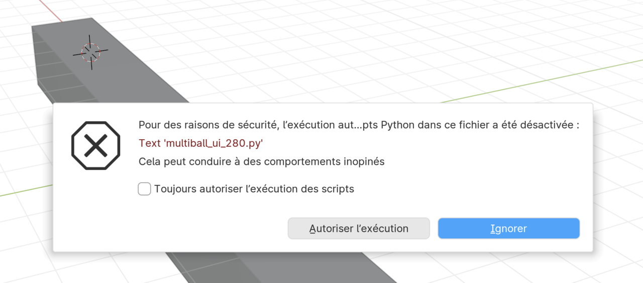

                    Just wondering… I close the file without saving it in order to start again. That reminded me that I got that warning when I opened it the first time but I didn’t bother because I thought it was because I am in Blender 4.0 (instead of 2.8). I clicked on Ignore. Should I have accepted instead???3-29 à 15.39.09.png

                      It’s just asking for your permission to run scripts, in case you got it from a untrustworthy source. I typically allow execution or set it to automatic so it never asks me again. I do this because I never go about downloading from weird places on the internet. If you ignore then the scrip wont run and if the rig needs that script it wont function correctly.

                        The term “Rig” usually means an armature object.  This is the container that all the bones live inside.
                        The keyframes you were looking at on the right in your screen shot are the values of the object.  The object is staying at 0,0,0, however the “Body” bone is being animated as seen in your Graph Editor.
                        I can see that you don’t have any keyframes on the object (or it will be yellow).  But the reason you have the connected line between the keyframes is most likely that you have keyframed other bones as well.  They will be the ones that don’t change value between the keyframes.

                        As for the warning message – Omar is correct.
                        That is Blender warning you that a script is trying to run when you open the file.
                        I assure you that it is safe (I wrote it – but it’s just the ui control script). The reason it’s warning you is that technically someone could write something that doesn’t something nefarious to your system.

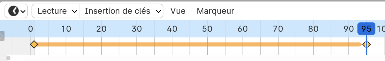

                          First: thank you Omar and Wayne for your concern. I accepted the script to run but it didn’t change the connected line between the keyframes. But I went on the exercise (because the animation was working)  and encountered many difficulties in understanding why I was doing some actions: that can be a mix of my (not good enough) English and some «Blender logic» I haven’t catch yet…  (Like: how can a linear interpolation can produce a parabolic path? Does the strategy «e minus 2», in order to remove frames, require a numpad to work? I dont’ have one and I’m on Mac. And why do I have white keyframes and yellow keyframes?) …I think I will take some rest now!!!

                            In regards to some keyframes being Yellow and some White, that shows which keyframes are selected.  (Yellow is selected, white is not selected)
