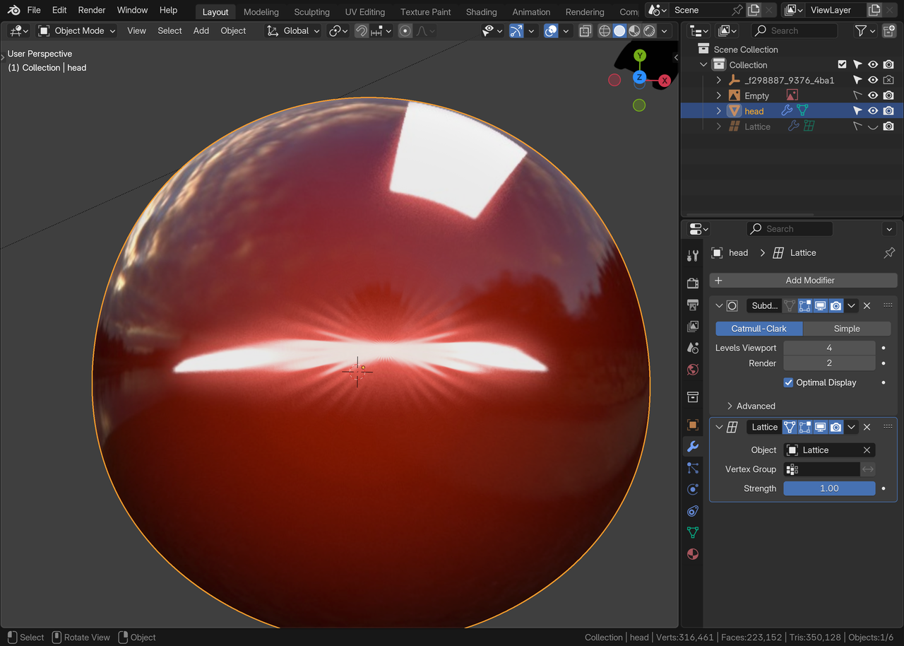

      Hi all, It’s been a while but I’m still plugging away. This is a common issue, no doubt. I’m working on a head and need it to be completely smooth. I have the shape I want but I would like to get rid of the star pinching at the apex and still retain the curve so that there is no flat spot. As ever, help much appreciated.

        That is indeed a common issue; you shouldn’t use Subdivision Surface Modifier on a UV Sphere, because of the ‘pointy Triangles’ at the Poles.
        For a smooth Sphere, it is better to make it from a Cube, like this, for instance:
        That consists of only even Quads, which is often ideal.
        UV Spheres certainly have their uses (like for making eyeballs and planets), but don’t add a Subdivison on top of it.

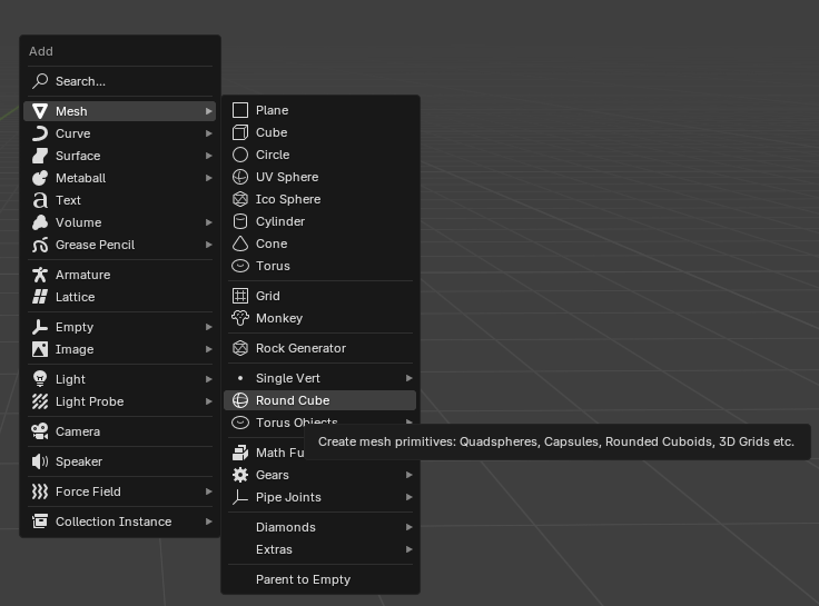

              Blender brings its own addon/extension from home with “Extra Mesh Object”.  The “round cube” can also be found there.
              Just for extra information
