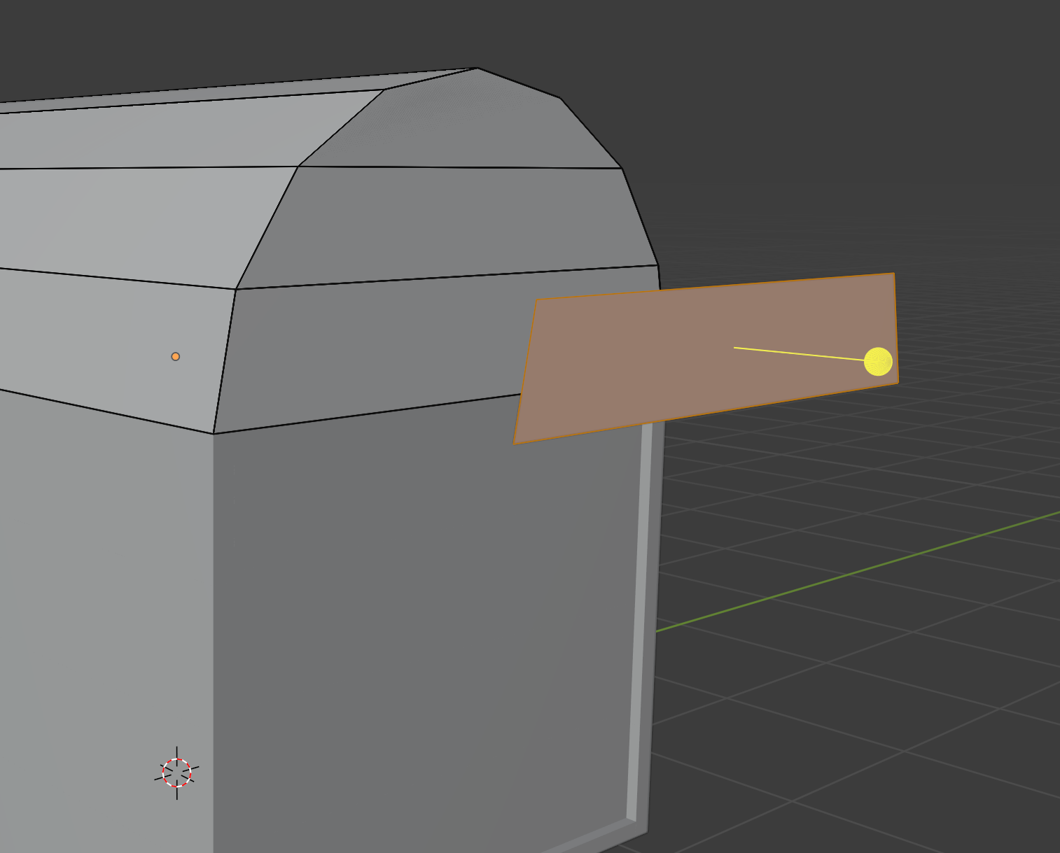

      If I split the face by “Y” and move it by “G”, then there will another same face on previous location. How to solve this?
      #60215
        It is possible that there already was a duplicate face before you split it with Y.
        Before splitting, select all with A and then use M > Merge by Distance to remove all ‘double vertices’. If you are using an older version of Blender and M doesn’t work, use ALT+M instead.
        #60216
        Yichun Li
          It works, thank you so much!
