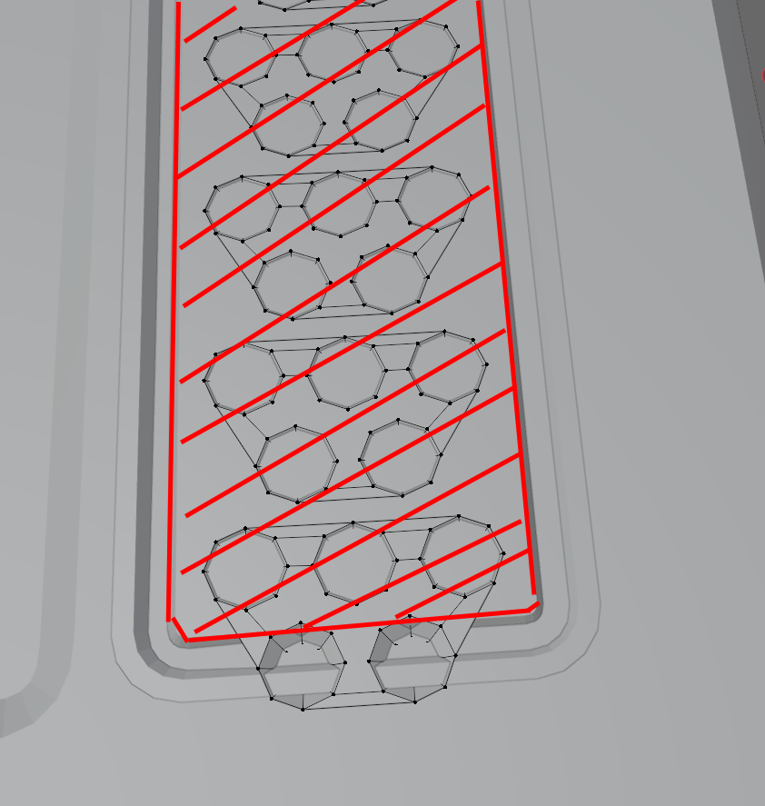

I vertex snapped the holes to the same level as the panel area like in the video, but for me it looks like the panel and holes are clipping through each other. In your video there doesn’t seem to be any clipping. What am I missing?
Hi James @coopster81 ,
You need to Delete this Face (part of the Speaker, probably):
Yeah, JL deletes that face at 4:36 in the video.
