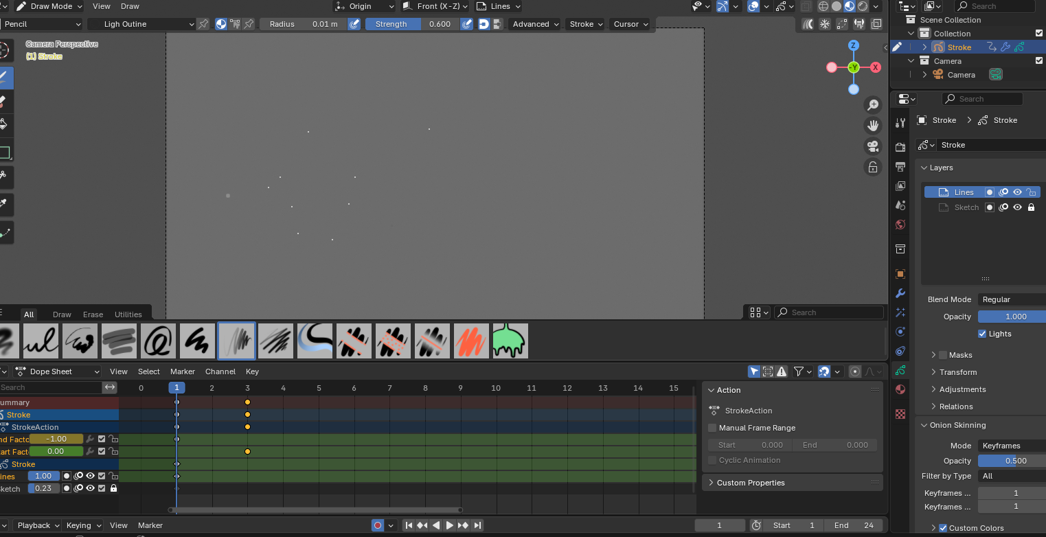

      Hello,
      As mentioned in the title, sometime when i draw, the lines don’t appear. And i don’t understand why. I checked if the active layer is locked and it was not. Is this a glitch? When i draw only a dot appears. i have attached a screenshot can someone help me with this?

        Hmm. What material is active for this stroke?

        Ethan Leadbetter
          I had the same thing happen to me. After going back and rewatching the previous video I found the fix for me, I had not selected a influence layer for the length modifier. After setting a influence layer for the modifier I was able to continue drawing. Hope this helps XD
