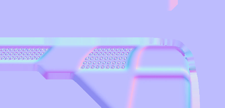

      After some attempts to bake normals I have  problem on the left side of object.
      I combined different approaches (tried to use only Displace or with subsurf to make more normals which be used in firing by cage) but instead I have result like this.
      Main corners checked like seam and sharp. The baking process was one object to one (door frame from high to poly)

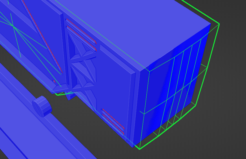

              I also found the reason for the yellow – the cage was covering the high poly objects fine in the front but not in the back:
