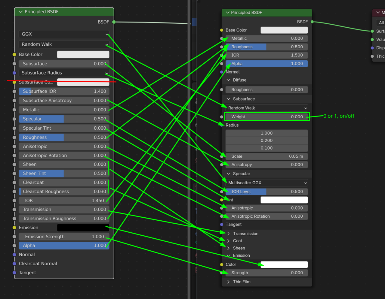

      Hello again, so i managed to follow along perfectly, apart from one issue i found, that being that i am using Blender version 4.4511, and when it came to changing certain settings for the material shaders, i found that my panel was different to yours, additionally, whilst your panel showed subsections such as Specular IOR and Subsurface Scattering IOR, mine does not, and instead has changed its fields to “weight”, “radius”, “scale” & “anisotropy”, etc, i had a little play to see what did what, but could not match what you did…

        The difference is mostly a reordering of the Settings:

          Was there one material in particular or was it just all of them? I did the course with 5.1 not too long ago and was mostly able to follow. I’m taking a look at the 4.5 Principled BSDF, and there’s a section with a drop down for Specular that has a IOR Level and on the Sub Surface Scattering, if you switch it to Random Walk Skin, that has an IOR value, though I’m not sure if those will match exactly what he did there.

            It was just those certain couple (subsurface IOR & specular IOR) that i couldnt find an exact or same named version on the nodes, such as the IOR, and yes, i should have really used the same version of blender, but i am fedup of having to switch over versions every time i do a different tutorial, its one part of all this i dislike and is a headache at best

              Hi Grady, they were there on his material panel, and yes he used both Specular IOR and Subsurface IOR when assigning materials, i wanted to replicate his exact settings so i had that baseline, then i could adjust for personal preference, but couldnt find the matching fields in 4.5, i did know there were some changes that put most into the Principle BDSF Node, but they aint all there and they arent all the same even if the text says something similar or even the same, it is a little confusing

                      You can’t delete verts/Faces in a UV Map. That is true of all software. You can temporarily hide them(H) and unhide them (Alt+H), or move them (G) or scale them down to 0 or really small (S). Remember that UV Maps are just a 2D layout of your mesh. Now if you’re using UDIM you can separate them into different textures, but they still are part of the same UV Map.
                      All the principal nodes were updated, both under the hood and in its presentation/layout. Some things were renamed to make it clearer since somethings were misleading. Also, Cycles has been revamped, and the default color management profile has changed. That is why it’s commonly said to adjust materials based on what you see and not by matching numbers exactly. This is a hard one for me, because I’m very much a match the numbers person. I’m also more technically minded. That’s why video editing, rigging, and TD are easier for me than modeling and the dreaded sculpting. I’ll finish the sculpting course someday. With that said, Sticking with one version does add an additional layer of anxiety and frustration, but can also be very rewarding. Especially if you like those spot the difference puzzles.
