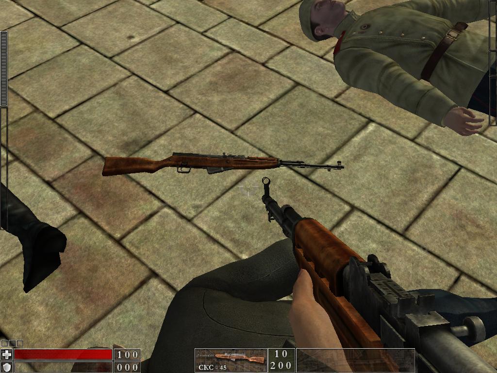

              @jgonzalez , OK. If gun is around player count it +1. if player moved and gun is not around player it should count it  -1.. That is what i need to do. I don’t know why script count it wrong !?

                AeleaS Omer
                  @jgonzalez . It detects when a weapon is within the trigger zone correct? Yes Is there a reason why you need it to count up or down?  I want player knows how many weapons he can grab near him.
                  Zero  means no gun on player zone. If there are 3 guns on player zone that means 3 weapons. He moved a bit forwarded and 2 guns on his zone, weapons value = 2. and so on. I wrote -1 to tell you zero. No need to any value under zero. Just count correctly the number of guns inside player zone. Thats all.

                  AeleaS Omer
                    @aeleas , I solved. There is not issue with your scripts guys. I think it’s from guns objects or tag function !!. What i did to solve this I put empty_object and named “handle’. add collider, radius 1.3.  change my script from using tag to name. Done ^-^. thank you guys.
