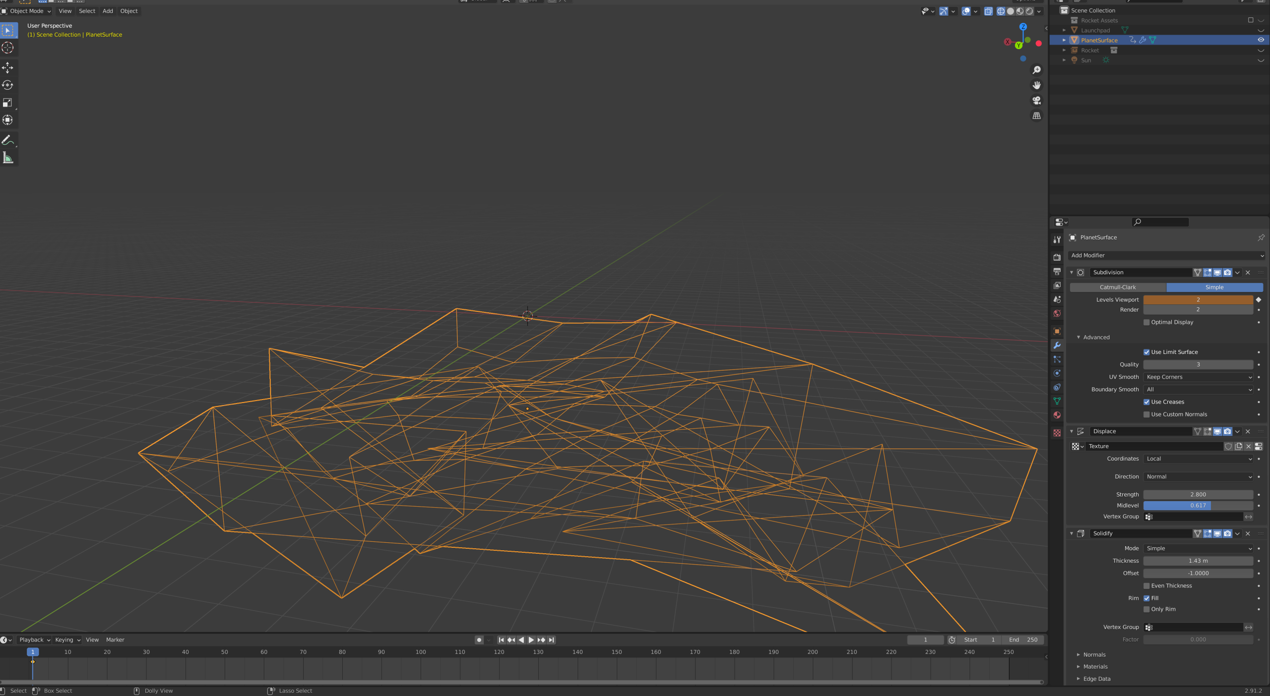

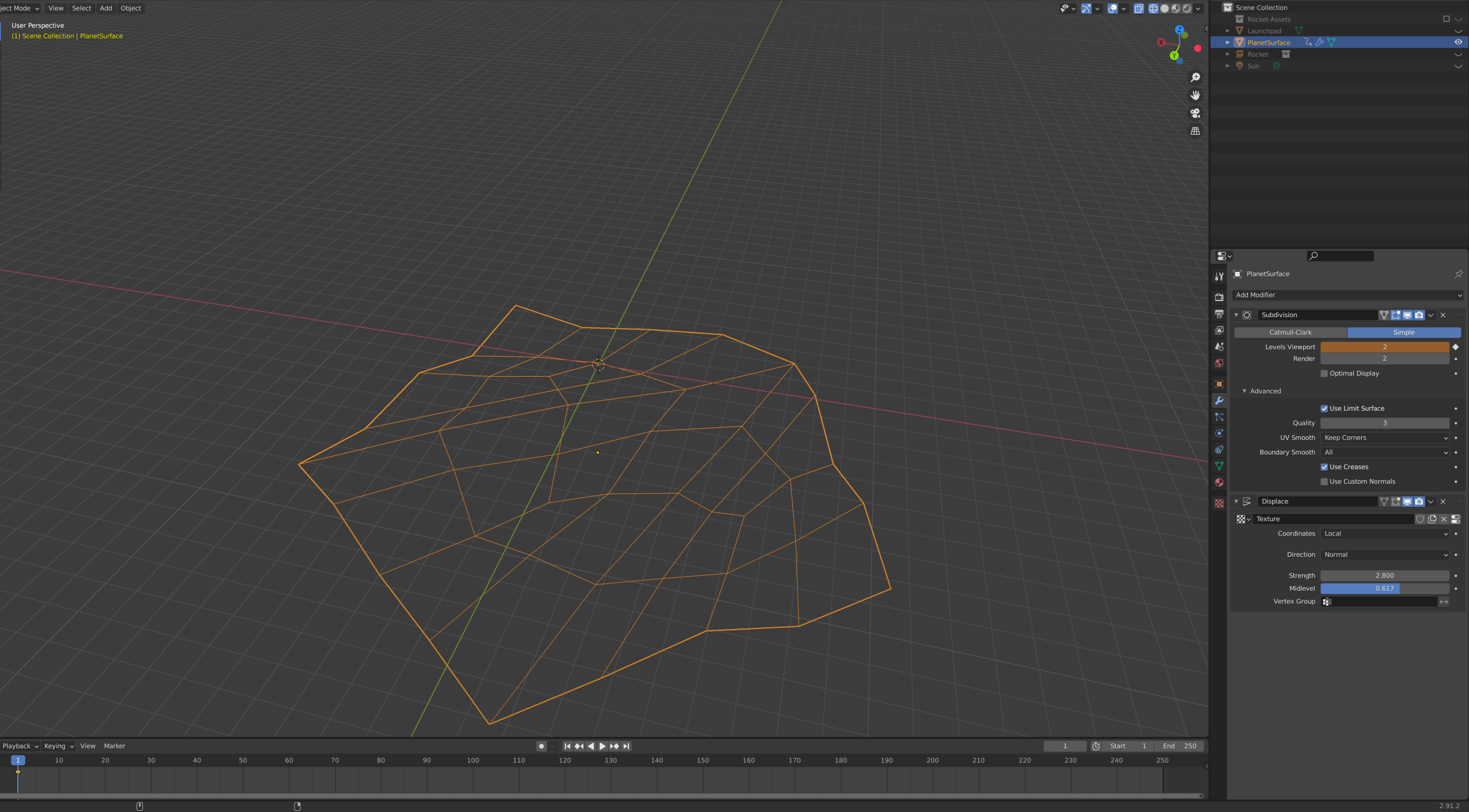

      When I add solidify modifier instead of acting similar to extruding down is blows the mesh all over the place
      Link to blender file: https://share.getcloudapp.com/d5uwEgrl

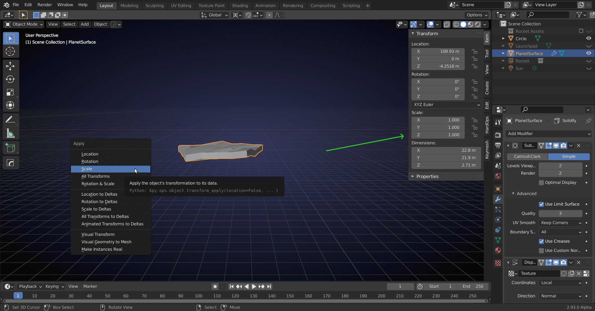

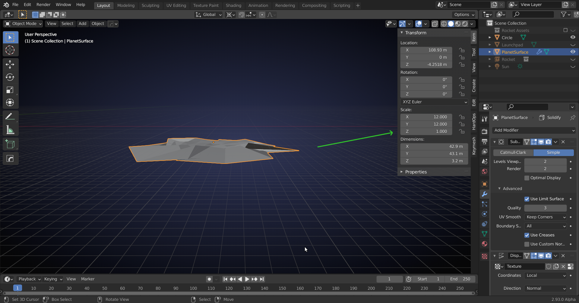

                @equalpoints your Scale is off (not consistent):
                Press CTRL+A > Apply Scale:
                #62783
                Yan
                  Wow, thanks =)
