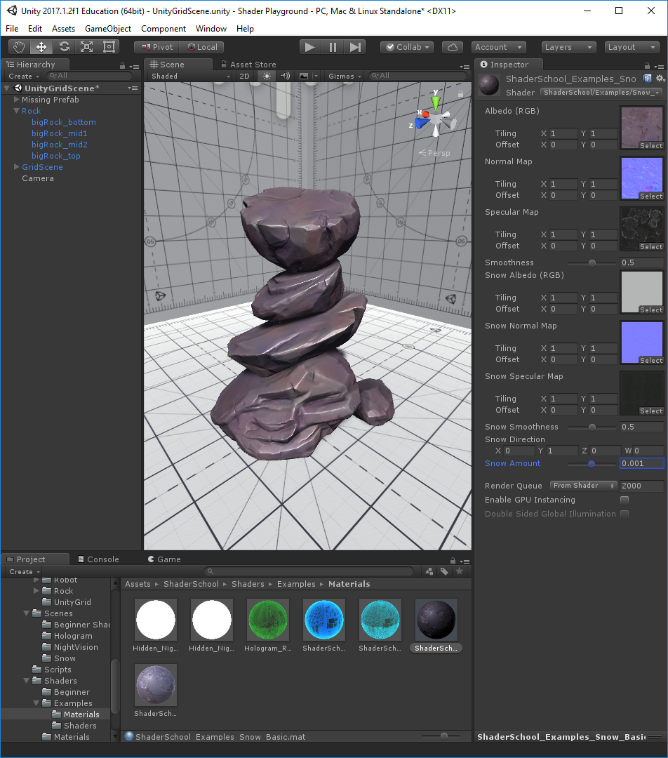

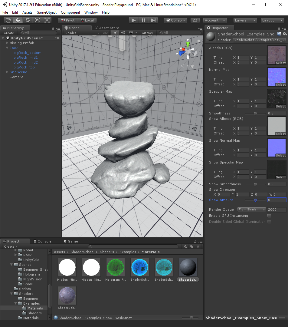

      I was following the tutorial and got to the point at 11:10 in the video, where you apply the material to the rocks. What happens in my project is that the shader either applies the snow to the entire rocks’ surfaces, or not at all – it doesn’t respect the dot product like it does in the video. I also tried out the “ShaderSchool_Examples_Snow_Basic” material, and the same thing happens.
      I’m suspecting something wrong with the dot product calculation, but I’m not sure why it works on your version, while it doesn’t work on my version, when they’re both the same.
      Does anybody see the problem? Again, I’m using the example shader provided from the downloads.
      Snow amount > 0:
      Snow amount <= 0:

            I created a new project from scratch and imported the download files just in case I had any duplicate names. I loaded the included scene called “Snow_Basic”, and the rocks are set up to use the shader called “ShaderSchool/Examples/Snow_Basic”.
            I have an ASUS ROG gaming laptop with an NVIDIA GeForce 980M graphics card, if that’s useful information. I just updated the graphics card driver, and the problem persists both before and after the driver update. I am using Unity version “2017.1.2f1 Edu”.
            I tried using the “Snow_Fade” scene, and this one fades like it’s supposed to. Still not sure how my project doesn’t calculate the gradual snowiness though.
