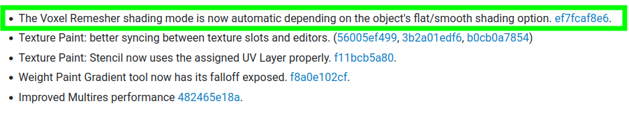

Can’t seem to find it either. Sounds like you now have to go into object mode, right click and shade smooth manually. Funny enough, the dynamic topology still has the smoothing option.
Since Blender 3.0:
