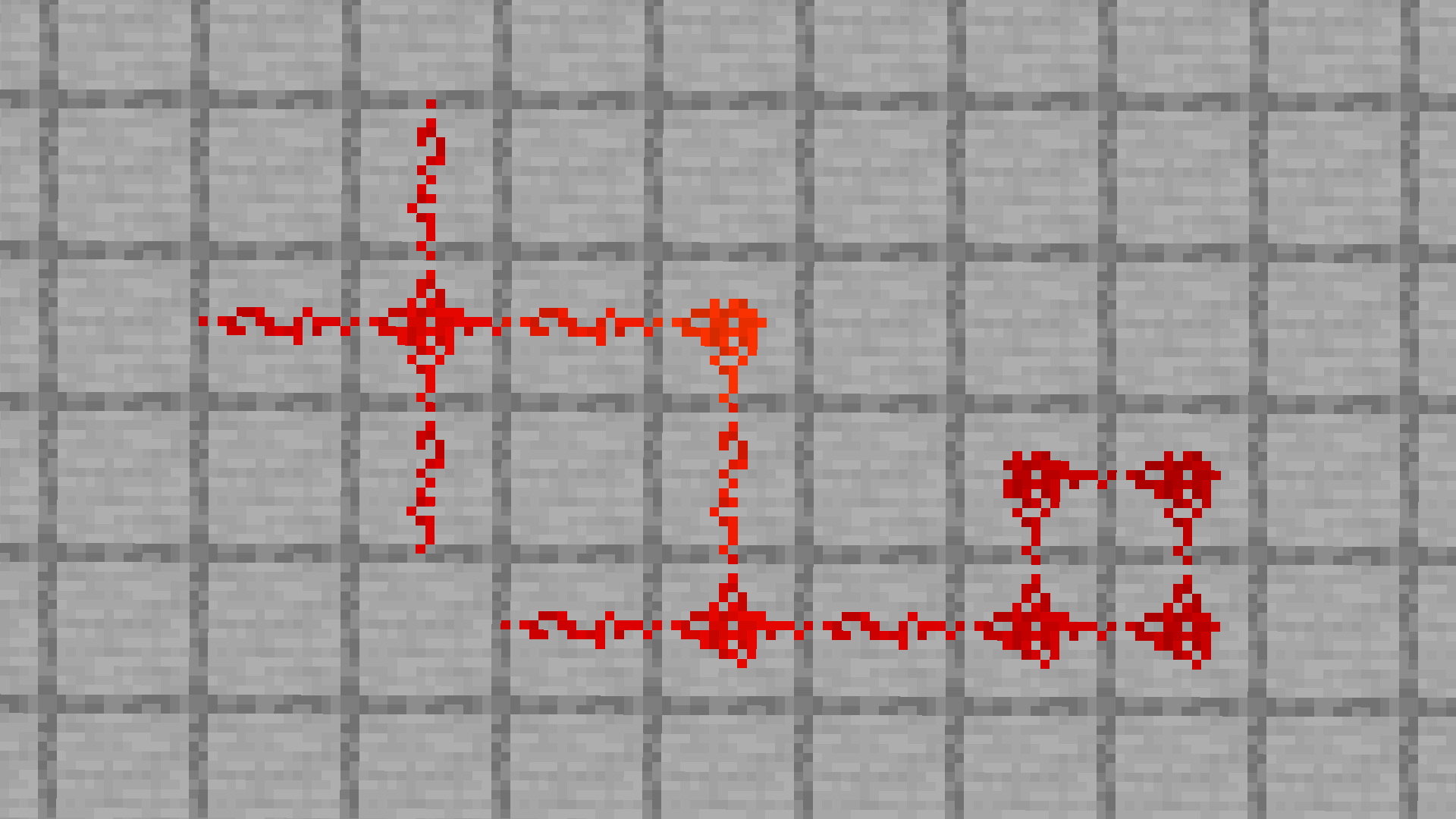

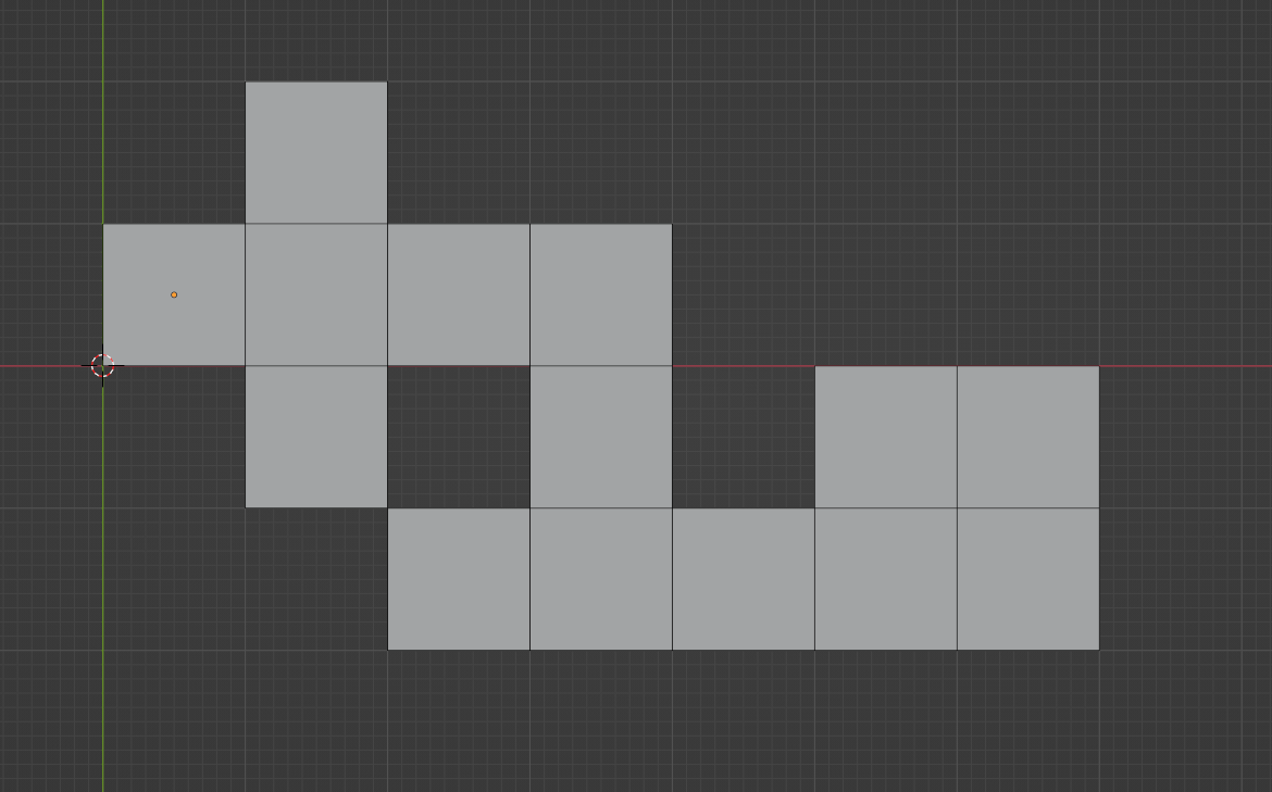

      Essentially, I start with a setup like the first screenshot’s and I want to assign a different texture to each face depending on how many tiles they have traveled from the power source (the lightest redstone dust), and depending on where adjacent faces are. (Each face is 1m²)

                Minecraft operates on a grid of 1×1 tiles, and every block has to conform to this grid (redstone dust being no exception).
                In this example the base geometry is a set of 1×1 faces as to respect said grid.

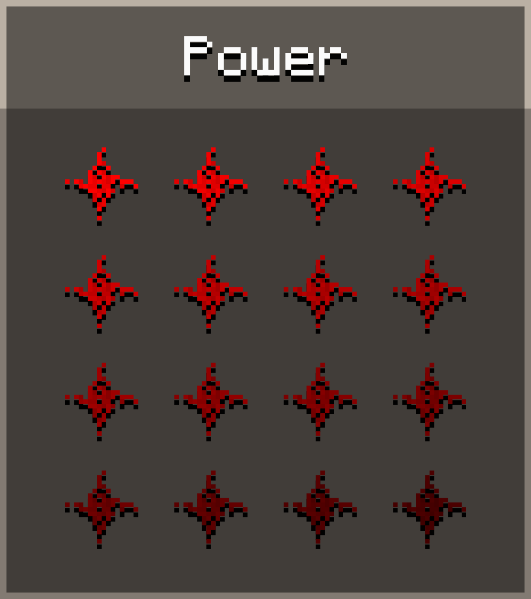

                Another quirk of redstone, is that it has a Signal Strength Power.
                The signal strength can vary from 15 to 0, but how do you know which signal strength it should have?
                Well, by default redstone has a signal strength of 0, no power.
                If [x] is a redstone dust where x is the signal strength,
                an 18 blocks long, straight line would look like this:
                [0][0][0][0][0][0][0][0][0][0][0][0][0][0][0][0][0][0]
                Right now, there is no power, so we need a power source, that is, assigning any signal strength to a chosen tile (or face, in this case).
                If we chose the first redstone dust to have a power of 15, our line would suddenly look like this:
                [15][14][13][12][11][10][9][8][7][6][5][4][3][2][1][0][0][0]
                The power propagates from the source depleting by 1 for every tile it crosses, and stops going down once it reaches 0.
                If the original power source was around the middle, and we gave it a power of 5, here is what our new line would look like.
                [0][0][0][0][1][2][3][4][5][4][3][2][1][0][0][0][0][0]
                This is how the signal strength changes, but what about the color?
                It’s pretty simple actually, for a pretty accurate representation of the color in game, you only have to worry about the red channel.
                I found this simple equation to work wonderfully : 12*power + 10

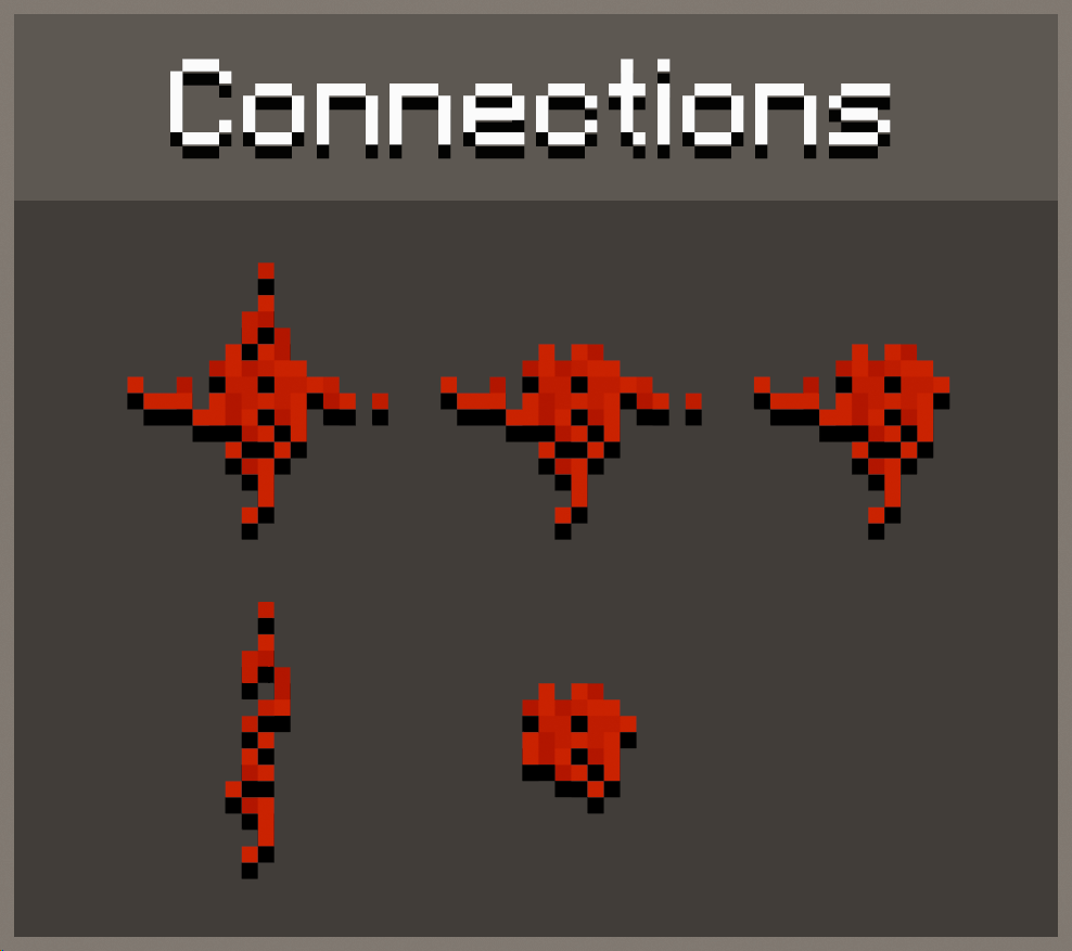

                Now for the other way redstone dust’s textures dynamically change : Connections
                This one is simpler to explain, redstone will visibly connect to any directly adjacent tile.
                Starting from the top right and reading right to left and top to bottom :
                The first one in the image above would be connected on all 4 sides, the second would have 3 (on the left, bottom and right), the third would have 2 (on the left and bottom).
                The fourth one is special, it will either show if it has a connection on the top and bottom, or if it has a connection on either the top or the bottom.
                (The fifth one is honestly irrelevant to the question and can be completely ignored)
                Note that this isn’t every possible case, but all of these can be rotated to create any possible case.
                If we had a redstone dust with an adjacent to it’s right and top, we could rotate the third one 180° to get what we need.

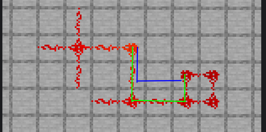

                #89120
                  So, if I understand this correctly, there is no simulation, but you ‘draw’ the tiles and want the patterns and colors to be set automatically.
                  If you’re not too fixed on using GN, here’s what you could do for the Power/Color:
                  Just Duplicate the tile and move it and calculate the Manhatten Distance to get the Strength (numbers can be tweaked to set the Strength of the first tile).
                  The patterns for the connections are a bit more difficult and might not be do-able with just Shader Nodes…
                  #89121
                    Oh, I obviously didn’t think that through!
                    Here it already goes wrong; the Manhatten distance (in blue) is less than the traveled distance (in green):
