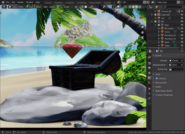

      Great video. Thanks for great content. But how come there is no shadow to the chest in this scene ?

        I think that is one of the limitations of EEVEE, but you’d have to ask @theluthier

          @ireshef Eevee is fairly capable when it comes to shadows..so it should be casting in this scene. Could you provide a download link to your .blend file (via drobox, google drive, or equivalent hosting service) for me to take a closer look?

              In reviewing the source file, I could have done a better job equalizing light source energies. In the GIF below I do a few things to improve it:
              1. Turn the World energy to 0 to show that there are shadows being cast from the sun.
              2. Increase the Sun intensity 10x
              3. Set world strength to 0.5 (half of original.
              4. Finally disable shadow casting for the black dome (which is meant to approximate the out-of-camera forest)
