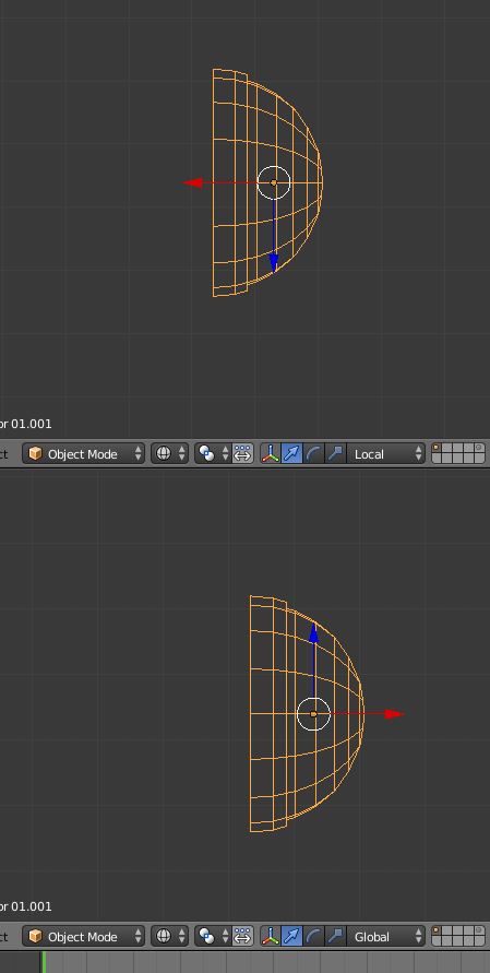

      Hi to all,
      as you can see in the pictures I’ve some object with the local axis set in a different way compared to global axis.
      What is the right way to set them with the same orientations?
      Thank you and Kind Regards
      Federico Violin
      #31085
      Kevin Mather
        Select object (in object mode), Control-A, apply Rotation
