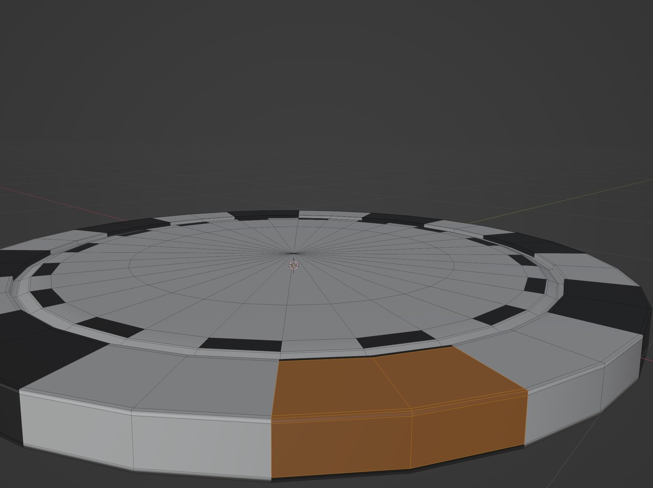

      I have this chip and it took me a long time to select all of the faces that have the same black color. I tried using SHIFT + G, but nothing on there selected the faces I wanted.
      Is there a way to select faces based on the same color? And is there a way to save what you have selected so that you won’t have to do it all over again?select by color.jpg

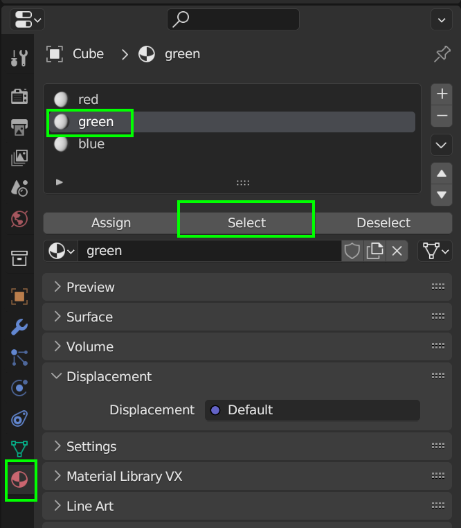

        You must have a different material for the different colors, right?
        So, with one of the faces you want selected, SHIFT+G and select material.
        #78775
          …Or:

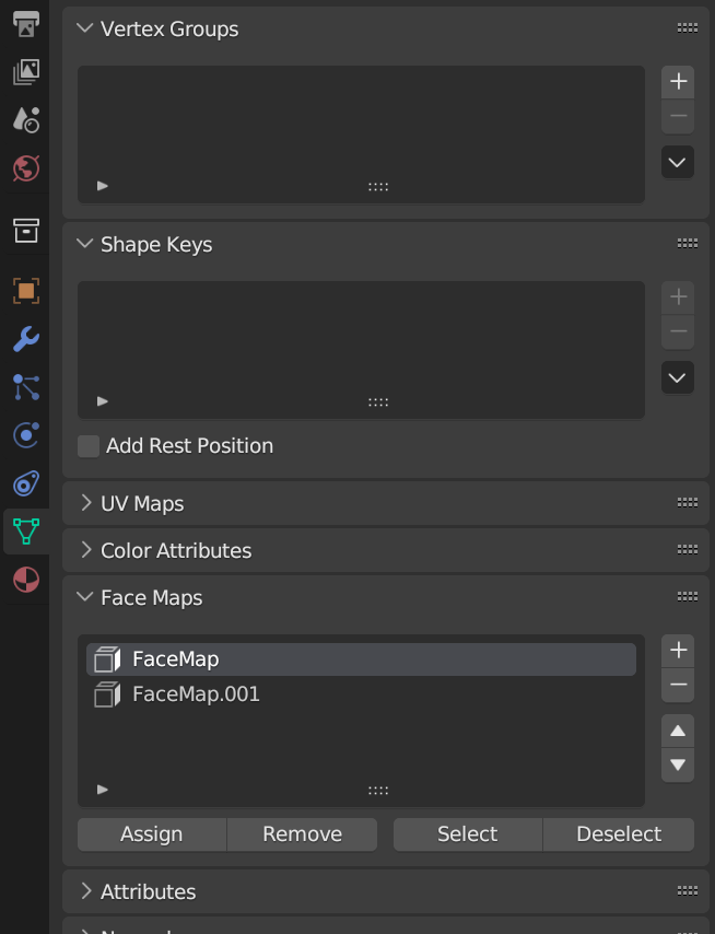

                Or even easier: Face Maps:

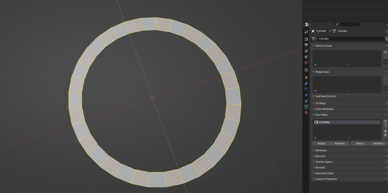

                          #78784
                            Hey Omar @dostovel ,
                            Face Maps are Vertex Groups, but then for Faces, so you can make a Face Map like this and Select it:
                            As a Vertex Group, that would Select everything.
                            If I remember correctly, they initially wanted to call them Face Groups, but then were worried about users confusing them with Face Sets…or something along those lines..
