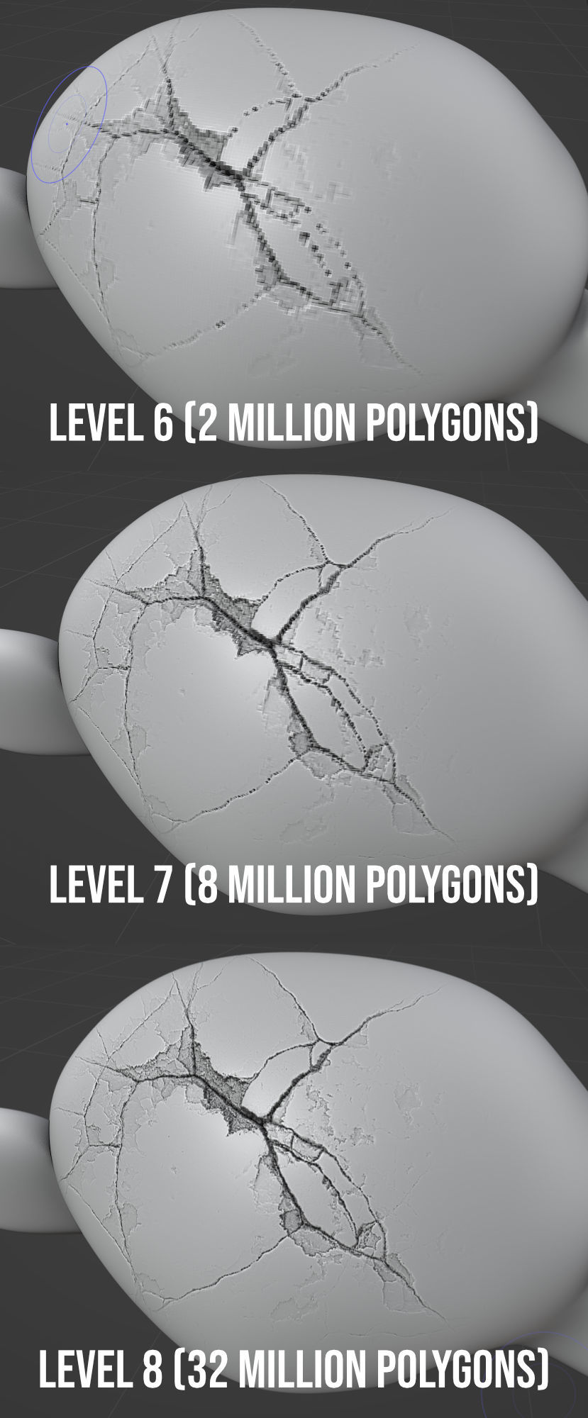

      I’m trying to add details to a model that will be 3D printed and I’m using a 4k alpha brush but it’s too pixelated unless I use 10’s of millions of polygons. Is that right?
      ie with the back of Suzanne’s head as a test, I’ve used a Multires modifier at Sculpt level 6 (2 million polygons), then 7 (8 million polygons), then 8 (32 million polygons).
      Do I really need that many polygons to get the detail quality I’m after or am I missing something?
      Thanks in advance.
      #76390
        Hi Ross, you do need a lot of polygons, but the back of Suzanne’s head doesn’t have high density to begin with. You’d have to retopologize Suzanne first, to get an even Topology. It’s not so much the total amount of polygons, as it is the mesh density in the area you are sculpting on.
        As comparison, my Human Head had about 15 million Faces for the fine details (pores and wrinkles), but that’s a whole buste, with even topology.
        Also, if it’s going to be 3D printed, think of the resolution of the print.
        #76391
          Yes, there’s no way around that, if you want that very crisp detail, you’re going to need lots and lots of polygons. That’s the limitation and it’s why people use textures like bump and normal maps instead. And it’s why a software like ZBrush is held with great regard, people go crazy with millions and million of polygons in it.
          #76392
          Shawn Blanch
            @rfranks I totally agree with Martin. Consider the ability of your 3D printer to print the level of detail that you need. If your printer can get really detailed then go as high as you need to on the poly counts (as high as your PC can handle). I typically need above 2 million polygons on damage brushes like the one you are using. But I don’t typically go above 10-15 million or my PC starts to hate me.

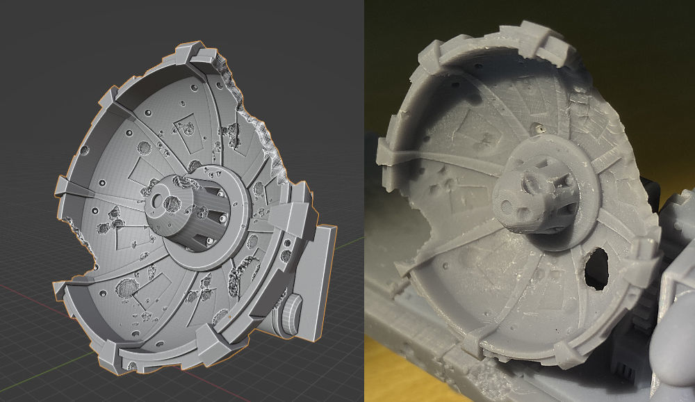

              Ross Franks
                Thanks for all your replies guys, I went with Dynotopo and it came out alright on my 4k resin printer, I know on a 6k or an 8k it would be even better and I’m trying to future proof it too.
                Thanks again.
                #76395
                  Turned out great if you ask me. That’s a cool model. Thanks for sharing your results.
