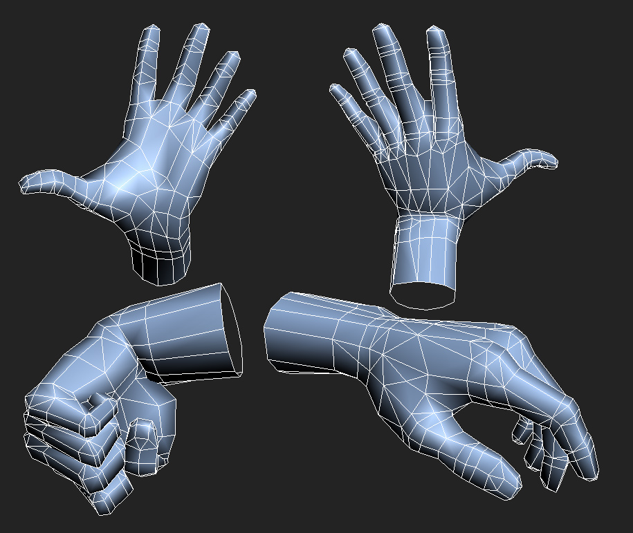

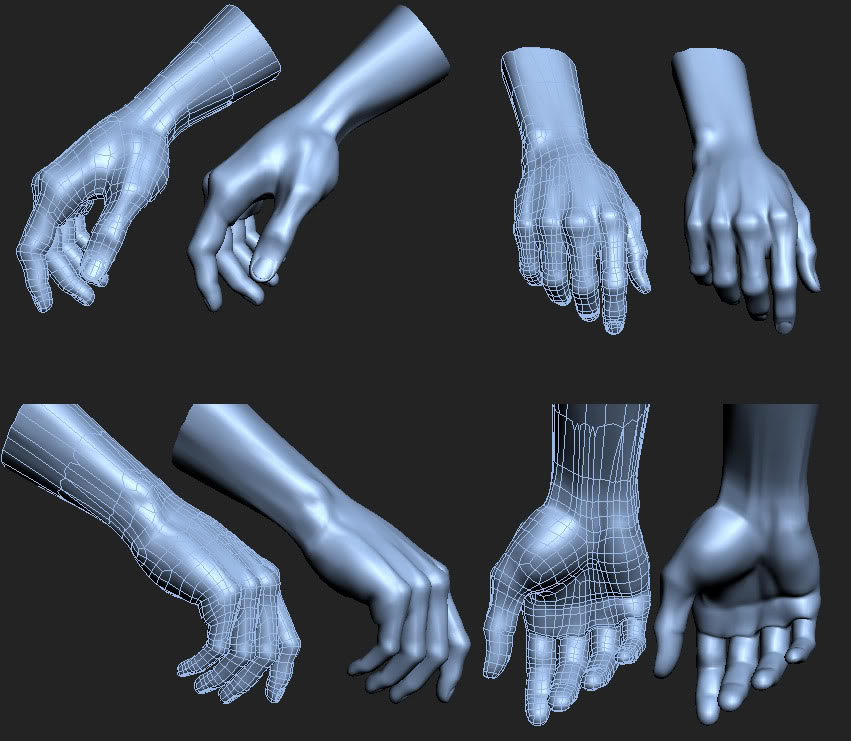

        It’s definitely good to have detailed hands since they’ll be so close like you said, but currently VR needs to have a bit lower polycount than regular PC games. I once modeled a character for a VR game and the whole person was about 16,000 tris, so 15,000 for a hand is too high. For VR specifically, try to use as few polygons as possible and make up for the lack of detail with higher resolution textures whenever possible.
        Here’s a good example of what to aim for when it comes to poly count:
        Minimum detail:
        Maximum detail if you really, really need it:
        Source: http://wiki.polycount.com/wiki/Limb_Topology

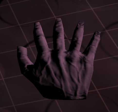

            As soon as I saw the hand in VR, I realized that I had major issues with the sculpting. I think I will make it a habbit to quicky exporting to VR simply to preview the model. It makes it much easier to grasp the plastic shape than on a 2D monitor.
            Another thing that went awry is the unwrapping. It is almost impossible to Photoshop the texture into whatever weird mesh the unwrap decides on.
            I should learn to do a hi-poly baking, absolutely! But then I wont get those nice skin spores from the texture … is there a way to add the texture as a high map or something, before baking?

                I just did made my first low-poly retopo (190 verts) and baked my sculpt into a normal map.
                Holy cow! I know this is old hat to you guys, but to me, this normal map stuff looks like geniue magic!
                I really should follow Jonathans advice and take things one step at a time. Still, it’s really encuraging to see some results!
