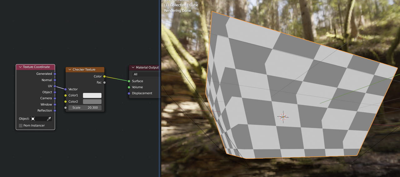

I wouldn’t use a Lattice to simply Scale an Object (although it’s possible), but if you use it to distort a Mesh, weird things may happen to your Texture, the noticeability depends on (the regularity of) your Texture:
Different Texture Coordinates give different distortions, but often you can get away with it (especially with hand-painted Textures) if the Lattice deformations aren’t too extreme.
