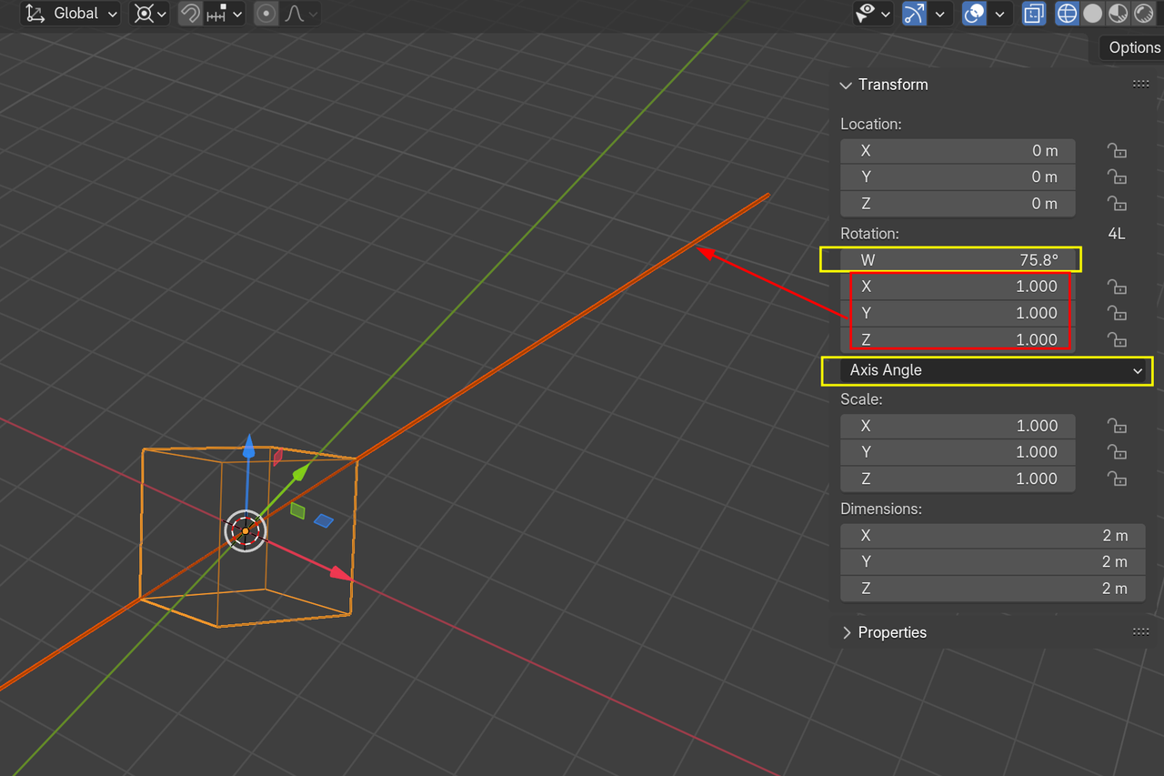

What do you mean with Rotating all Axes 5° ?
R, 5 will Rotate the Cube 5° along the View Axis.
Rotating 5° on the X-, Y- and Z-Axis can’t be done at once, so you will Rotate on each Axis one after the other, but that would give different results, depending on the order of the Axis; First Rotating on the X-Axis and then on the Y-Axis and finally on the Z-Axis, is different than first Rotating on the Y-Axis and then on the Z-Axis, and finally on the X-Axis.
Rotations in 3-dimensional space are really complicated!
