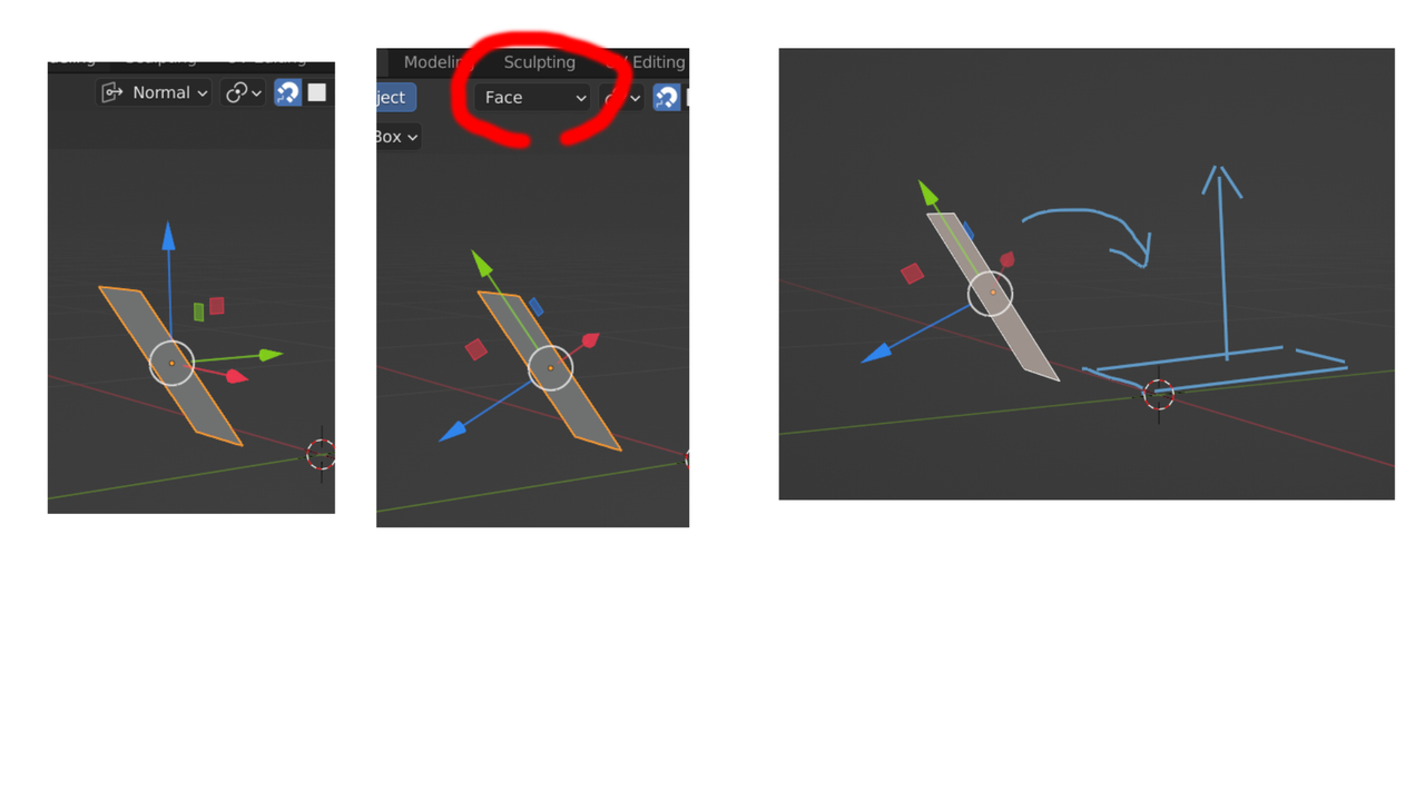

      I would like to turn a plane that is currently very odd  in space so that it is lying flat on the floor. Unfortunately, I can’t do this with the normal transform orientation because I’ve already applied the rotation. that’s why I’ve already created a transform orientation from the face. Now all I would have to do is bring the Z axis up so that it is pointing straight up. Does anyone have an idea?

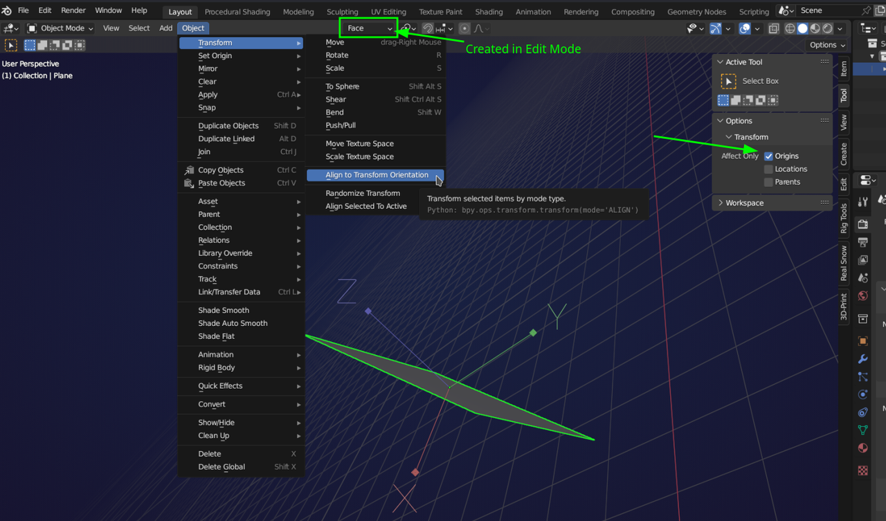

          But here’s a way to do it:
          The trick is to make a new Custom Orientation in Edit Mode and then enable ‘Affect Only Origins’ and Align to Transform Orientation:
          Don’t forget to un-check  ‘Origins’ when you’ve done this.
          Then, in Object Mode, you can simply Clear the Rotation with ALT+R.
