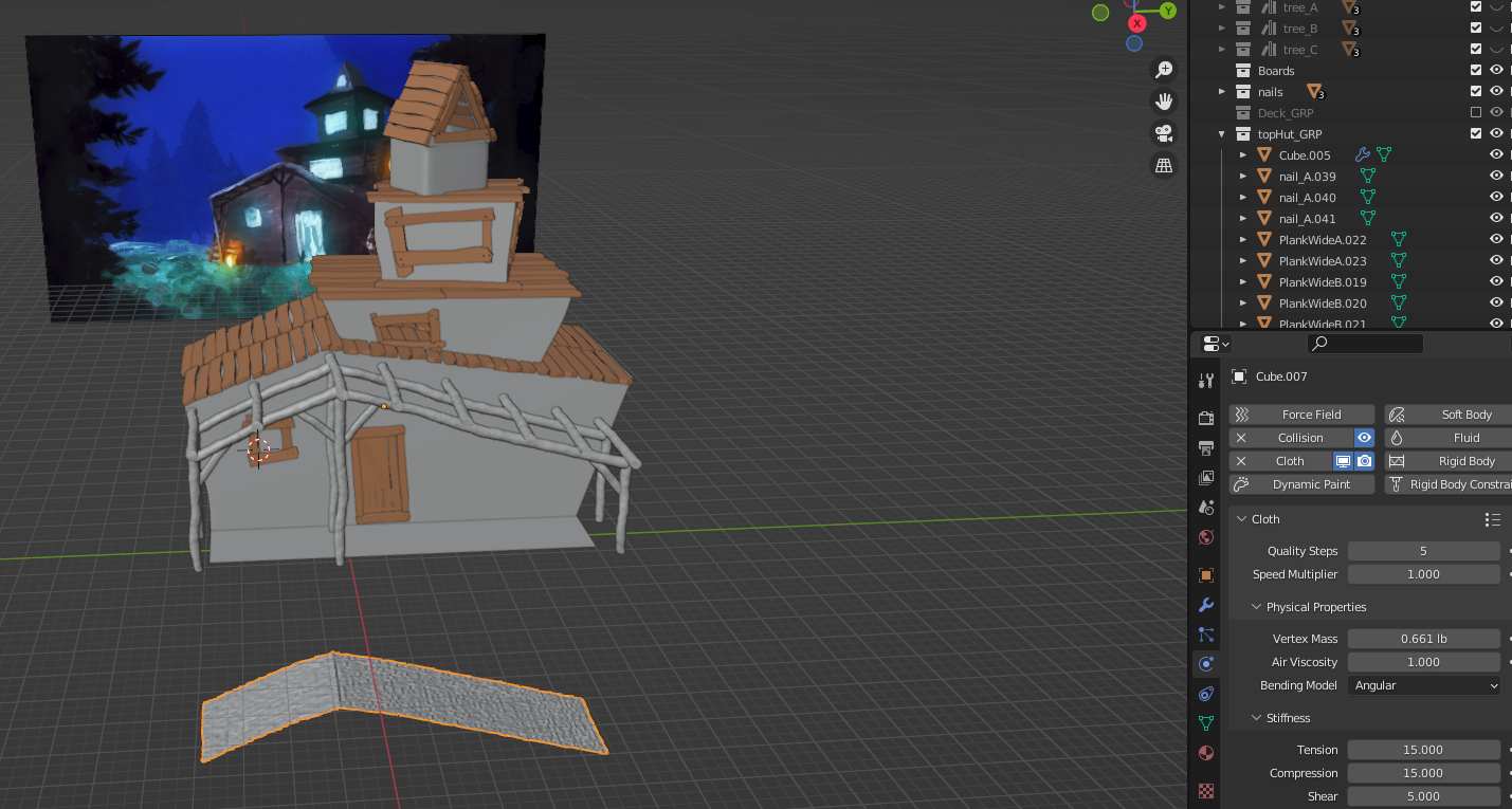

      Hello, When I set the roof position slightly over the beams (as you did). Its position is moved when I set the cloth option under the physics tab to it. Why does it change its position when I had it over the beams?
      #76285
        Hi @violetcrystal ,
        Make sure that you are on Frame 1, when adding the Cloth Physics. Maybe it’s something else, a lot can go wrong when setting up a simulation 🙂
        #76286
        violetcrystal
          Thank you, while starting at frame 1 fixes the position, it still goes through the wood instead of falling over it like a cloth. Is there a setting where the object to collide with it meant to be assigned? It’s not clear in the video.
          #76287
          violetcrystal
            Ah, the roof beams are set to the collision setting, not the roof cloth, I didn’t catch that.
