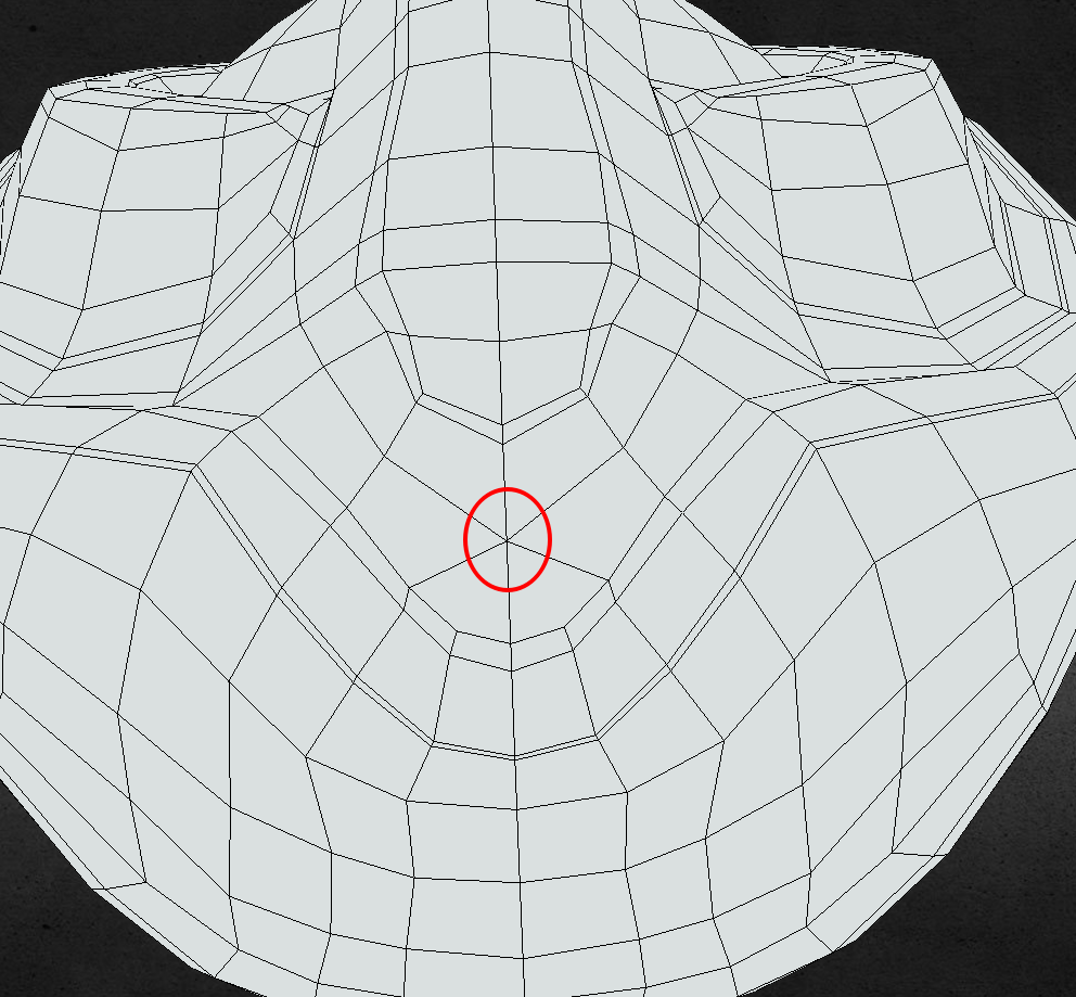

        Hi Brad, I’d like to see it without the Subdivision Surface Modifier..
        It’s not bad, but you have 6-sided Poles here (and symmetrically on the other side):

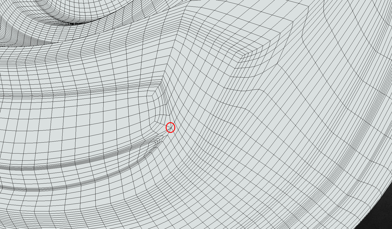

        and even 7-sided ones here:
        But I must admit, that those poles are not noticeable in the rendered version (not even with a shiny Matcap), so: good job 👍🏻

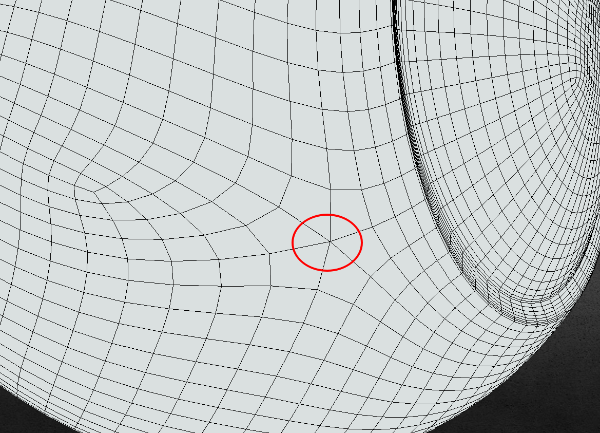

              I see that I missed another 6-sided pole at the back:
              but, like I said, they are not causing any shading artefacts, so, as far as I’m concerned it’s okay!

                Yeah, that 6 sided at the back of the top portion was from the course instruction so the poles seemed to let slide at this level, I think, but you’re right and something to be mindful of, as well as smoothing out the spacing better. The shetchFab wireframe is great for checking things out.
                    Indeed, I just checked my model and it has that same pole at the back…
