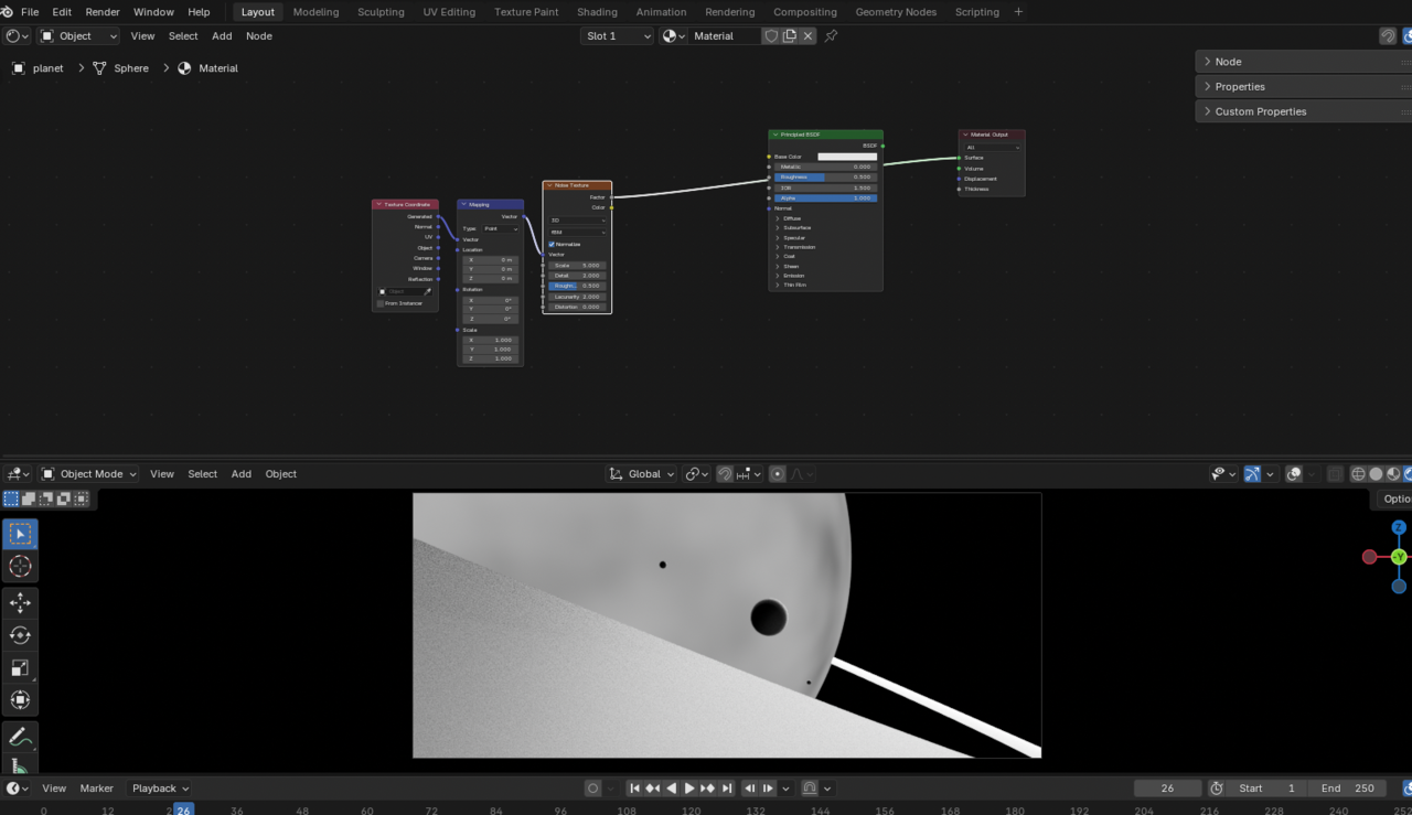

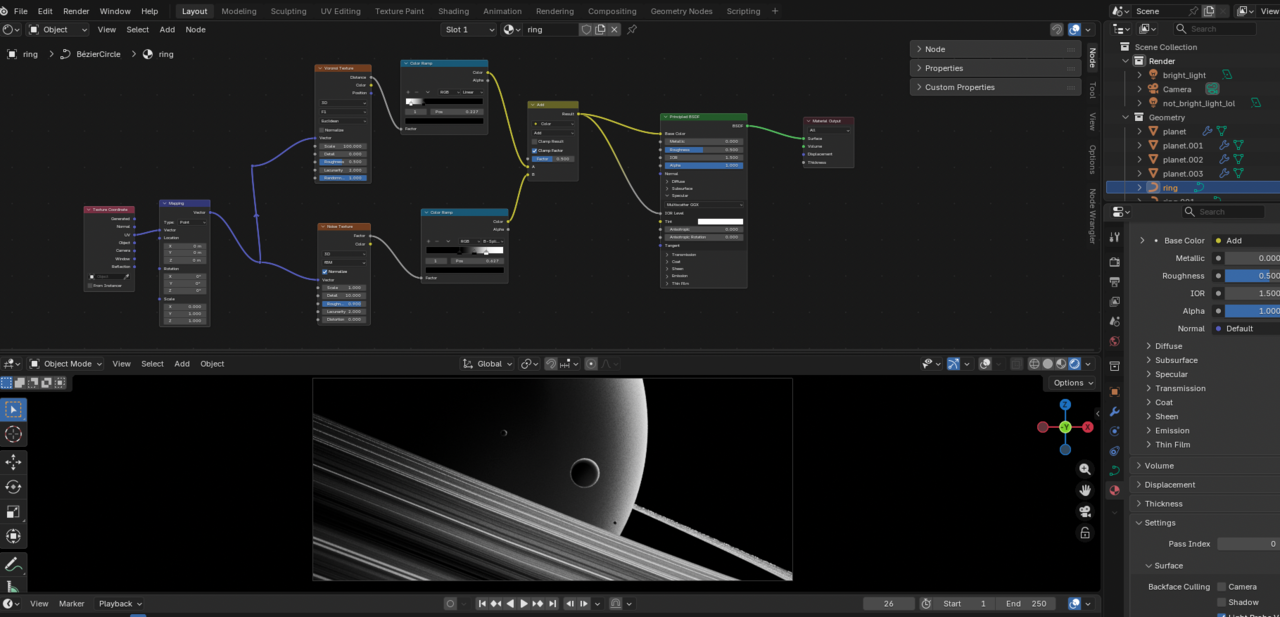

      #100731
      Nurzhan Zhaksylyk
        Here is before and after:

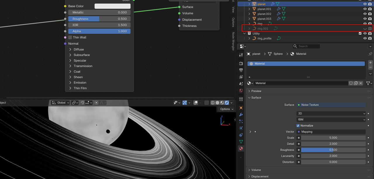

            #100734
              Hi Nuzran,
              The problem is not the Planet, but the fact that you have 2 Rings. Just disable (or Delete) the second one:
              #100735
              Nurzhan Zhaksylyk
                Thank you!! I’ve tried to solve this for one hour
