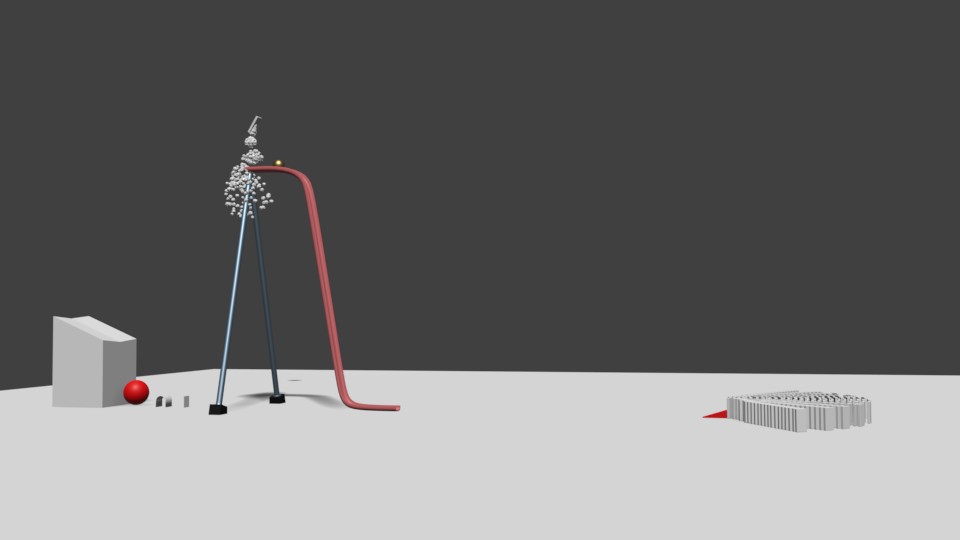

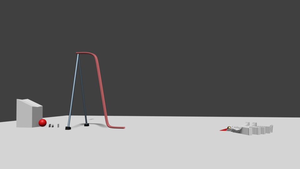

      I was running render tests in preparation for posting this exercise and discovered:
      1. On my slide, the small ball no longer collides with the dominos at the end of the ramp. All dominos were droppingl as expected. I made no changes  prior to testing  that would abruptly prevent the small ball and dominos from interacting as rigid bodies should and did.
      2. My flying domino is not visible in render mode
      3.Particles that were emitting from the flying domino no longer emit.
      So…..What have I done to sabotage this simple project.

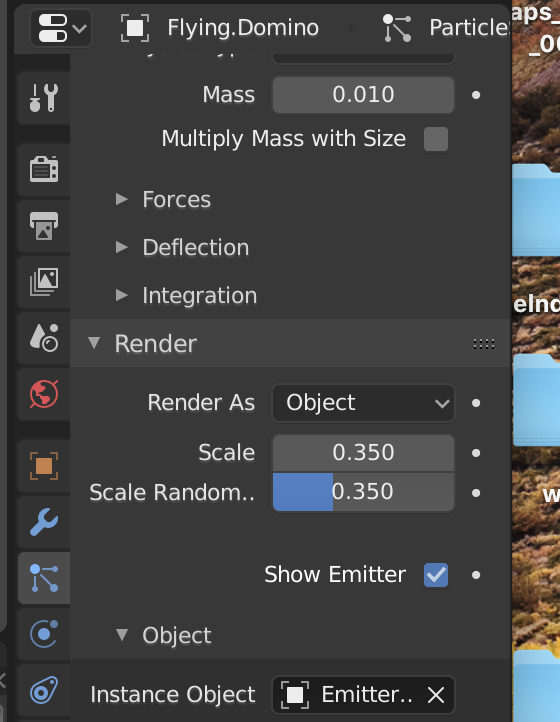

      #51205
      tanya
        Hi-
         2. You need to check the show emitter box in the particle section, otherwise it isn’t rendered.

            #51208
            Hans Salheiser
              Thanks Tanya,
              I mistakenly turned off the”Show emitter box” thinking it would show the actual emitter. Great!
