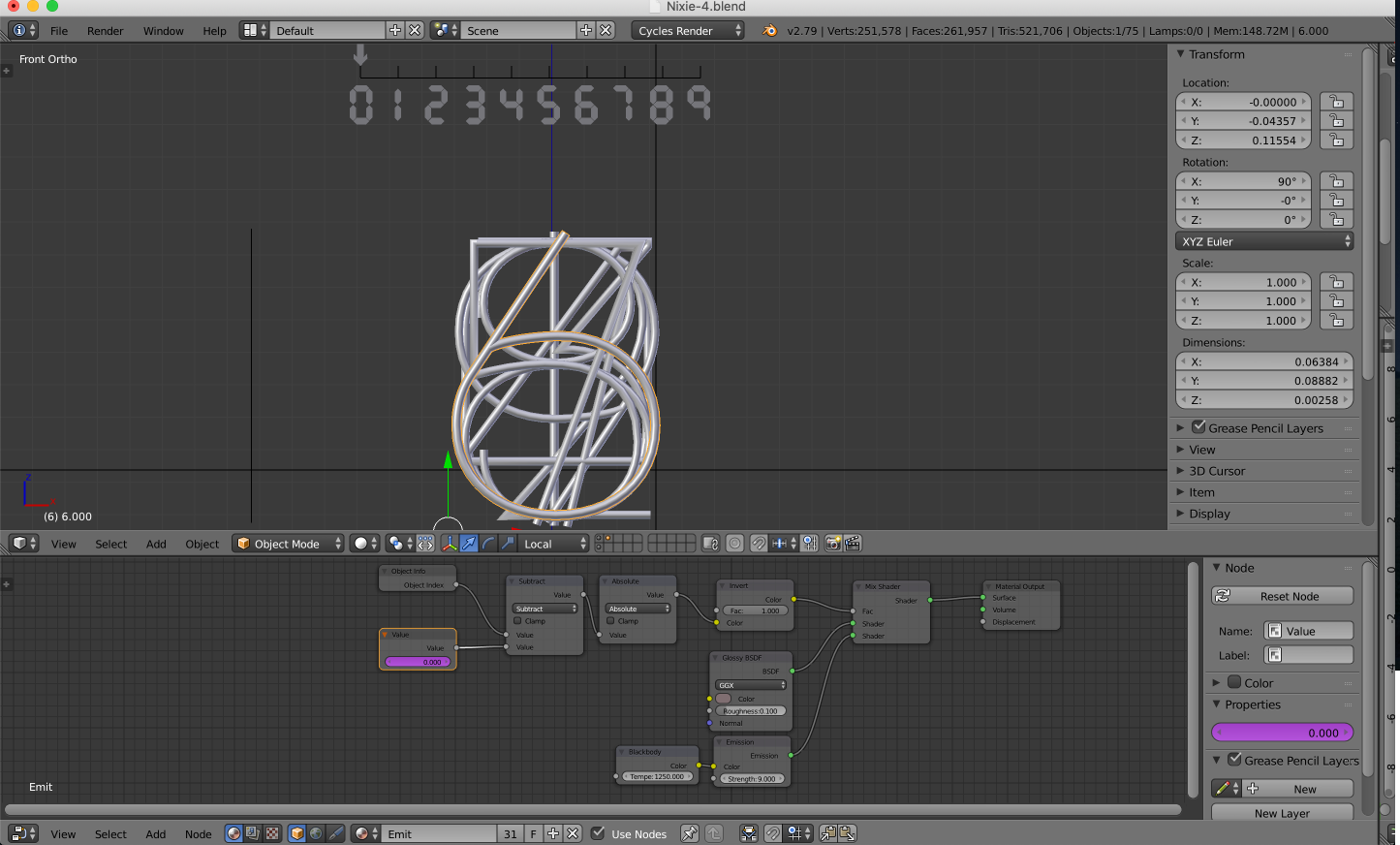

      I am trying to make a slider rig that when the arrow points to the value, the corresponding digit lights. Each number has a pass index value, and works when typed into the value node. I’m not sure connect the driver in my node tree to see the slider and slider numbers. Is it possible to connect the value node into a slider rig?

          @spikeyxxx I tried setting it up like you had it in a new file just to test. but my value didn’t change in the node or in the driver editor though. I’ll link my file of what I was trying to use the driver for.  value slider …. I also tried using empties and the distance type for the variable.

            @cptneclectic Hey Joey, I think I managed to fix it, so that it works the way it should.
            The main problem was the scale. I honestly can’t remember what I had to change exactly, because I had to experiment a bit and try and understand what was happening in your file..
            So, you’ll have to compare this with your file and see what’s changed yourself, but as far as I can tell, it works.
