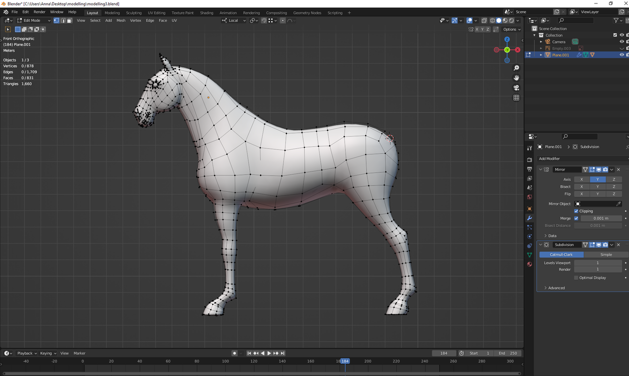

      Hi, i decided to practice modelling skills, so i decided finally to do my own work, would be grateful for showing mistakes what to improve(it seems i got too many poligons despite i can’t say there were so many before sub-d, i attached photo)
      Thank you in advance)

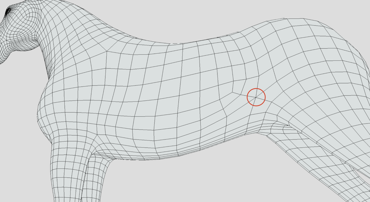

        It’s looking very good. Your loops flow very nice and in accordance to the main shapes. The only thing I noticed as an ugly six sided pole here:

            Adrian Bellworthy
              The topology on sketchfab looks excellent, however the six sided pole Omar noticed I would of dealt with differently.
              Green – Add edges with knife tool (All the way around to the opposite side)
              Red – Delete edges (Both sides)
              Blue – Edge slide vertices to even out the mesh (Both sides)
              As for the head, I agree with the @thehomme, I think the nose should be a little longer perhaps,
              and the side profile from check to chin is wrong, take a look at the image below

                Thank you everyone, anatomy was hard for me always, and last question is it ok it turned out too many quads?
                #82310
                Adrian Bellworthy
                  For a model like this, I think your quads count is a little on the low side,
                  I would prefer to see quads more evenly spaced, than areas with large stretched quads.
