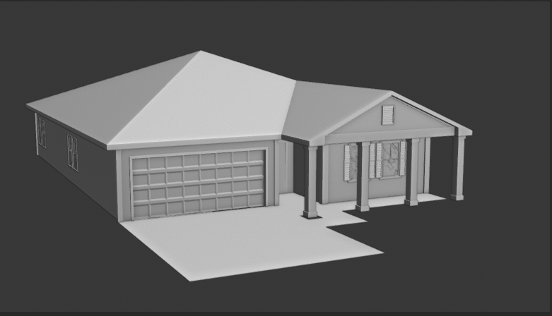

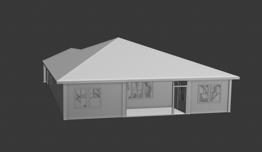

@dostovel, you mentioned ” There is a bit of z-fighting in the windows caused by two faces being right on top of the other and Blender can’t decide which to put forward…”
I did notice that too, same with floor in front of the garage door.
How do you normally go about avoiding/fixing that? I had the vertices of the windows snap the walls as to make sure they were on the same plane, but would you remove the faces behind the glass? Or would you move the windows an infinitesimal amount away from the wall.
I had the windows as separate objects so I could easily duplicate them, if it makes a diference.
